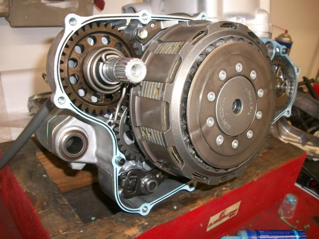

    my friends bike kicker blew up his right cover and right case cover :cry: i did the cases for him and all went awesome no probs till!! it starts up runs fine . put it in gear and it just stalls???? like the clutch isnt working ,but its all in and rod goes in and out.
    do i have the gear at kicker to clutch fliped backwards??? any help would be awesome!! he has a race this weekend!!!!
    thanks in advance...
    a picture of what it suppose to look like would be great!!
    by Asmith » Mon Aug 30, 2010 8:45 pm
    Here's a pic from an 08 450R I recently built. If the idler gear is in backwards, it would drag against the case.

    yuh wich way does it go? the crf is a little dif than my trx.
    i have it in the way that it sits flush with the kicker gear, im assuming it should be opposite prob huh...

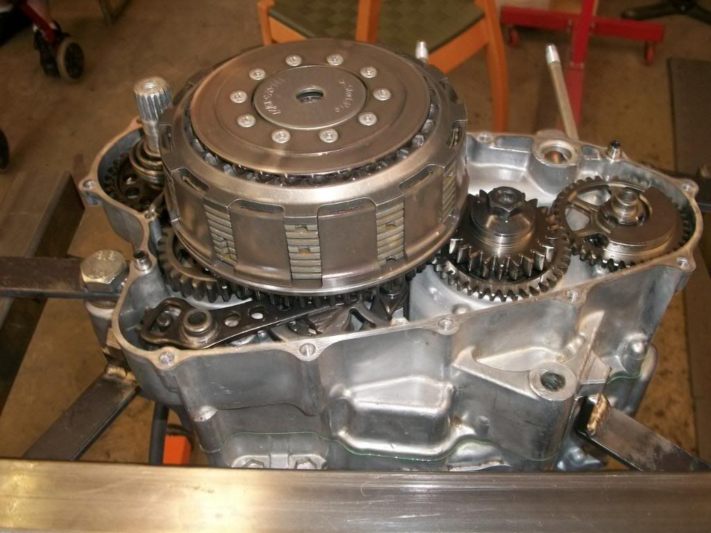

    by Asmith » Mon Aug 30, 2010 9:15 pm
    Does this help?

    by kevin132 » Mon Aug 30, 2010 9:26 pm
    yes it did! thanks . ill let u know how it goes tomorow!
