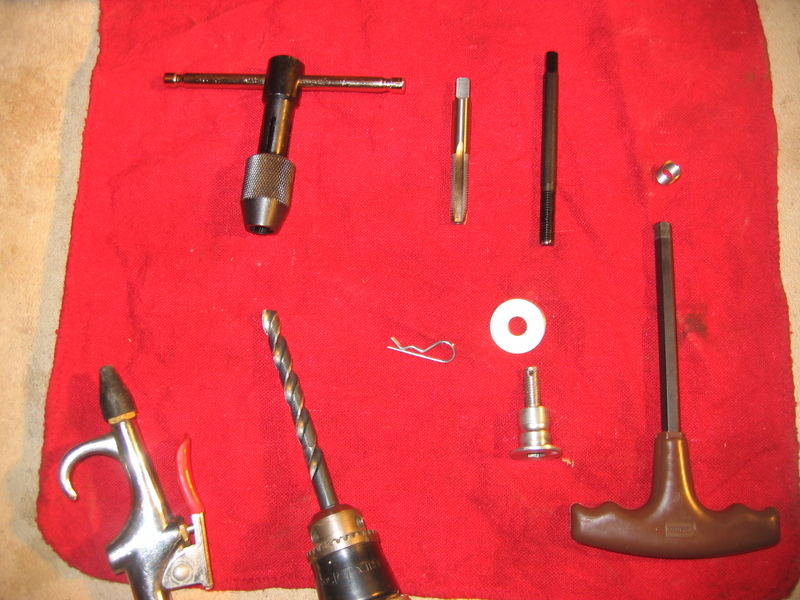

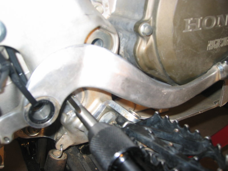

    OK, so I fixed my mistake last night with a Permacoil kit. The size of the pivot bolt is M8x1.25 for those who care to know. I practiced on a scrap piece of aluminum before hacking into my frame. It is pretty easy to do, and here is how...
    Tools needed...

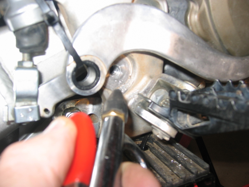

    First, drill out the old threads with appropriate drill bit. In this case it is a 21/64.
    Then, blow out scrap metal with compressed air.

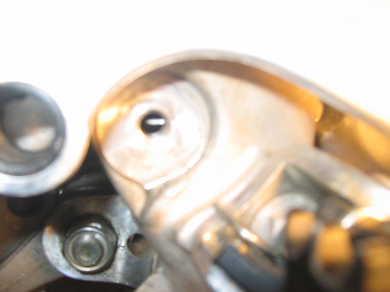

    Next, use a tap handle and the provided tap to cut new threads.

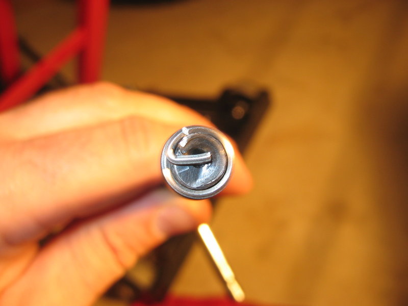

    Put the coil on the insert tool. Note the tang that is used to drive the coil.
    Drive the coil into the newly cut threads. Make sure you drive it far enough that no threads are exposed on the outside.

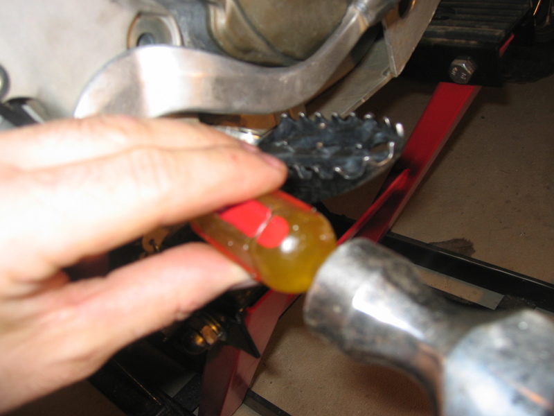

    Remember that tang? You will need to remove it.
    A well placed blow with a screwdriver will pop it off.

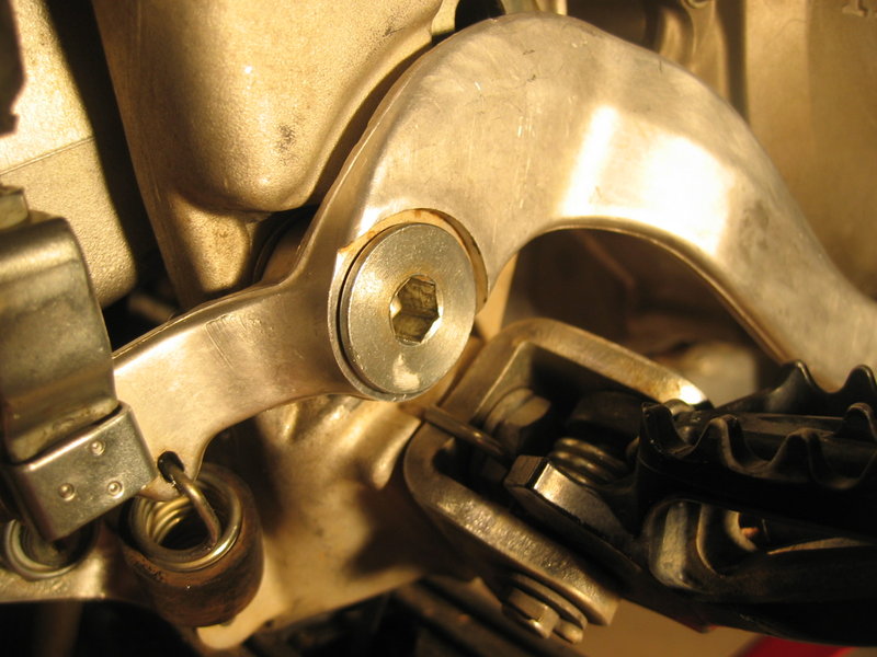

    Finished product -good as new!

    I think more of my problem was a boogered screw thread at the end of the screw. I had my machinist here at work turn the first three threads off the end of the screw and fix the lead-in...hopefully that will work. Luckily I didn't take all of the threads out with my kotter pin mistake.

    might want to use a little Loc-Tite on that insert.

    great suggestion dale.
