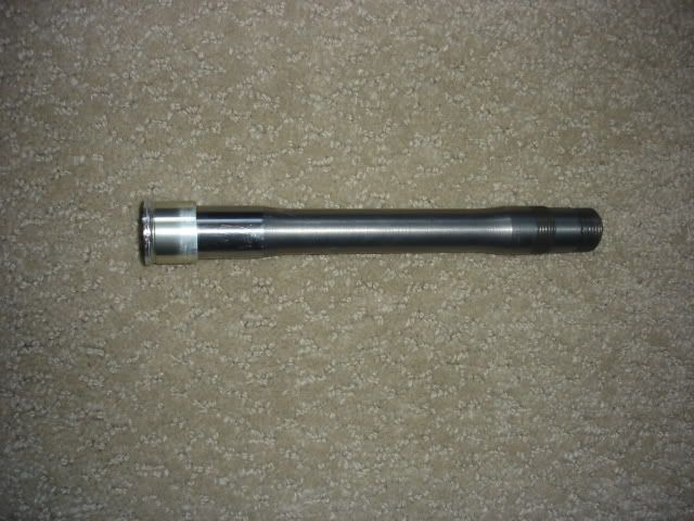

    Modified 230 stem w/bushing. Bushing made from bottom of CR250 stem

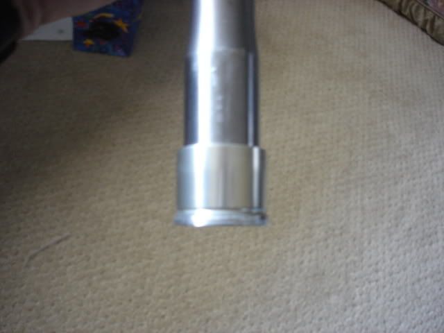

    Close pic of modified 230 stem (your eyes are fine the picture is blurred)

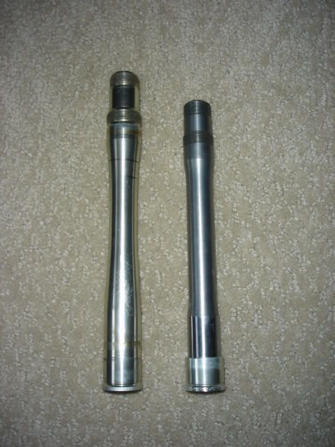

    CR250 stem next to modified 230 stem. Note the bottom of the 250 stem and the part used for the bushing

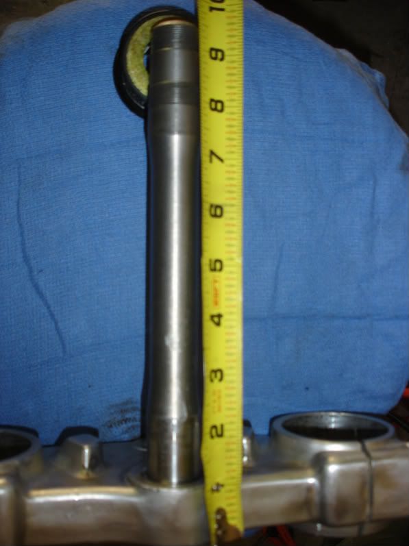

    Modified 230 stem pressed into 250 lower clamp
    Careful measuring is important; don't rush. My Dad always said "measure twice: cut once." If you don't you can cut it as many times as you want and it may still be too short.
