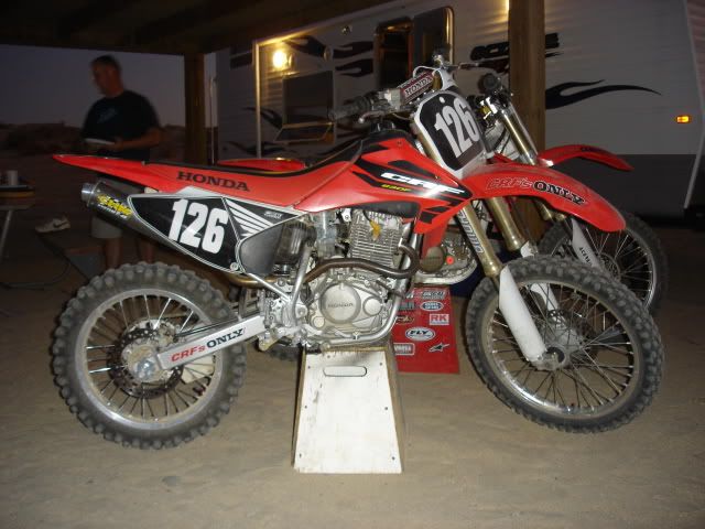

    Well here it is! The 230 Honda engineers had in mind before the guys upstairs slashed the production budget. This bike is a no brainier. The modifications I did (to swing arm, frame and triple clamps) to adapt these parts was very easy for a guy with a vision, a few tools, an Associates Degree in Nursing (no engineering degree) and a 10X12 Tuff Shed. I would have been cake for the high $ factory to have mass produced the bike using the 250/450X/CR250 parts (that they already had and that I utilized in my conversion) with minimal change in production effort or cost. My opinion: Most consumers would easily pay the increase in production cost for the benefit of the improved suspension and braking.
    I must say that after riding it back to back with my 250X there is still no comparison to the 2 bikes. The only complaint I now have is that the bike is under powered for its improved suspension. I hammered the crap out of this thing in some really whooped out desert uphills and it just soaked it all up much like the X. I didn't jump it hard because this shakedown cruise was also my first outing with 2 brand new knee replacements. :shock: I'm thinking though, that the suspension would have handled it better than the new improved knees. (although I can say that they didn't so much as whimper when called upon to do their stuff :D ) It is most likely going to be used as my bulletproof, low maintainance, trailridin, woods weapon. Did I mention that it also has a Works Performance rear shock?... I think I just did :roll:

    OD was good enough to stop by the world headquarters of CRF's Only to show me his handy work. you know when someone skilled does it right because it looks like it came that way from the factory...the HONDA factory. these mods look that way. in fact, you see the bike and it leaves you scratching your head wondering why honda doesn't build it this way to start with. i know, price point, market demand, etc. well, if people are going through what OD did to build it themselves it tell me there's a market for it.
    great work OD! you represented crf's only members well with this project!

    My project used a complete'97 CR250 front end (forks, triple clamps brake and wheel off of ebay about $400.00) Emig Racing has a stem that presses into the 250 triple clamps allowing you to bolt it right up. ($180.00). There are some additional things that you need to do for clearance purposes like heat the tank and cave it in, relocate the ignition box, build a new steering stop. I had longer throttle cables made.All of this of this sounds like a somewhat daunting task but in reality is quite easily accomplished. I have pix if you would like to see what you are up against. I also have a "HOW TO" on the rear disc that I can send you. As for the rear suspension, I went with the Works Performance rear shock (available thru this site) and the BBR linkage.
    I understand that the Race Tech Emulator fork kit and a fork brace, such as one by Summers Racing, also work wonders on the 230 forks. This would be substantually cheaper than the 250 conversion. Go to Thumper Talk and do a search re the Race Tech emulators and look for a guy named Dwight Rudder. He and Mike Coe (coeshow) have some good insite into the 230 suspension. Then come back here to order the parts you need to make it all happen.
    Whichever way you go I am more than willing to answer any questions or direct you to someone who can.
