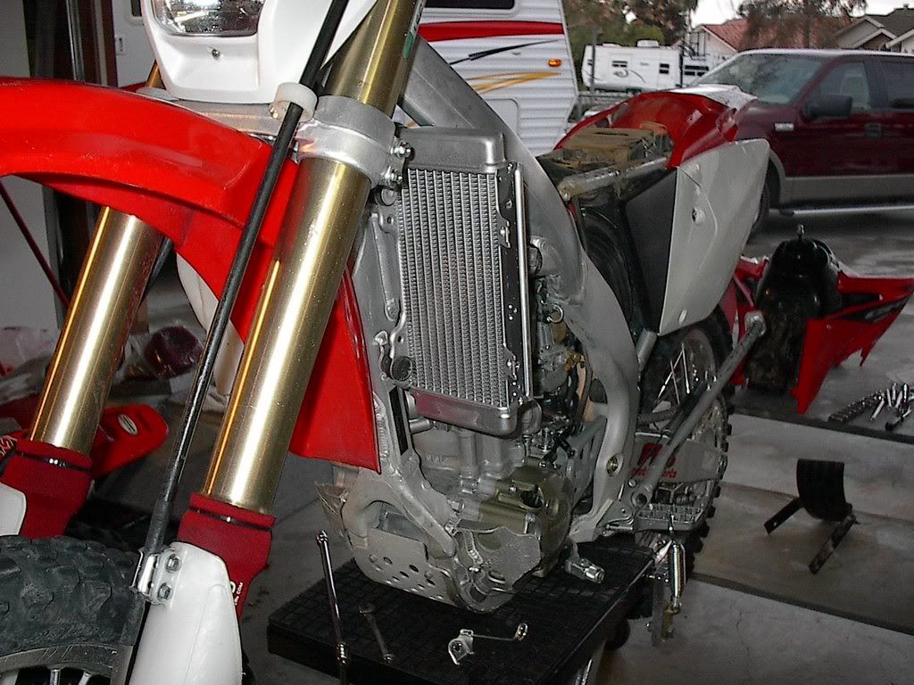

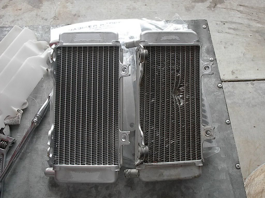

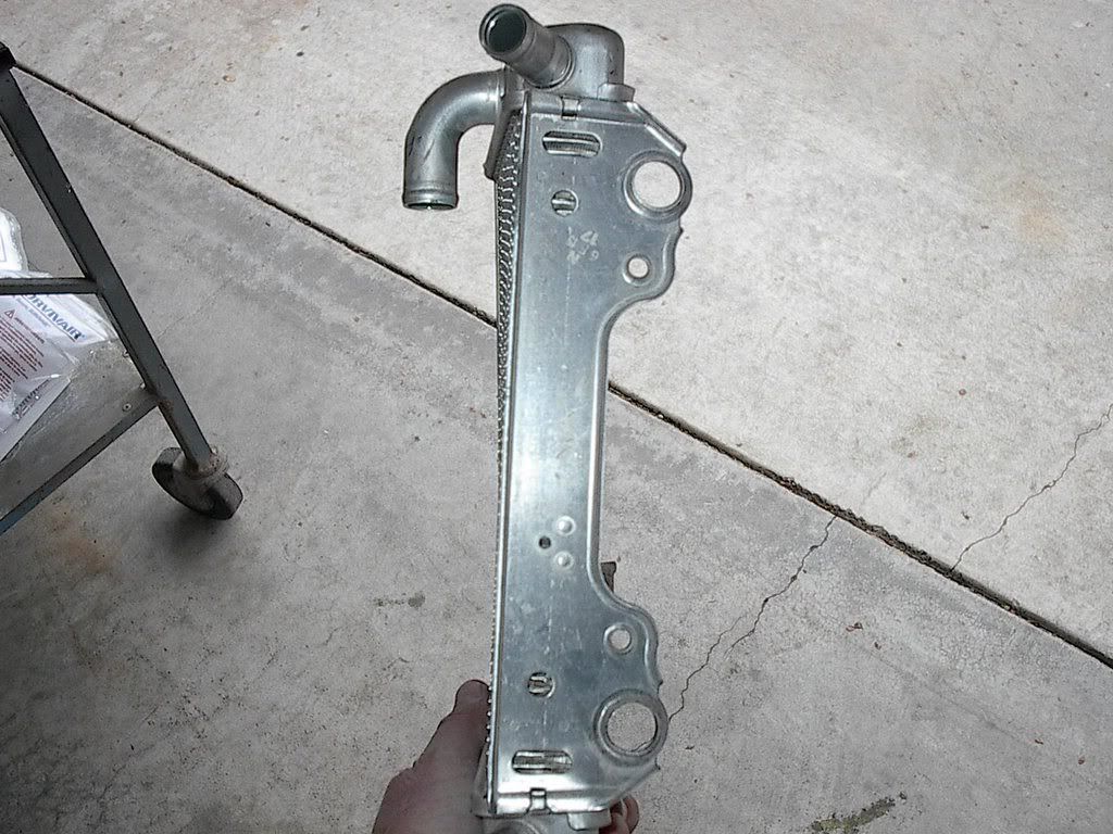

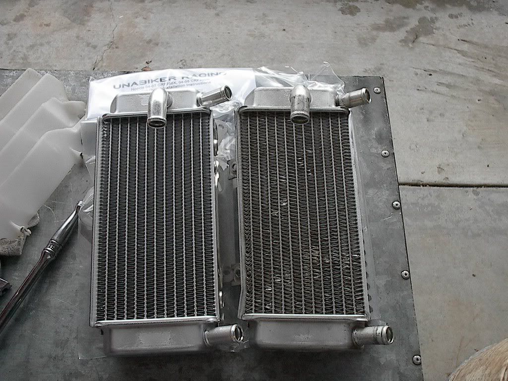

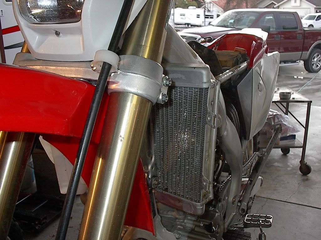

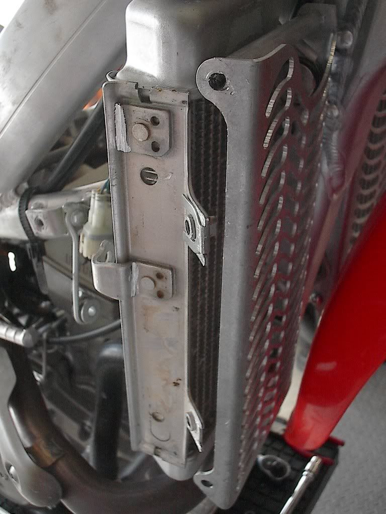

    -We first took the shrouds off the bike to get a clear view of the damage to the radiator I sustained at round 8 of USDR.
    -After removing the radiator hoses and unbolting the radiator we compared old to new...

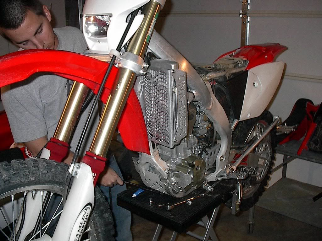

    -Next step we took was adding a slight finger of grease to the inside portion of the radiator hoses for easier removal incase we need to fix them again. Connected hoses to new radiator and mounted up and heres where were at now..

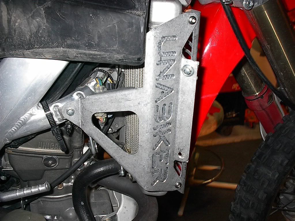

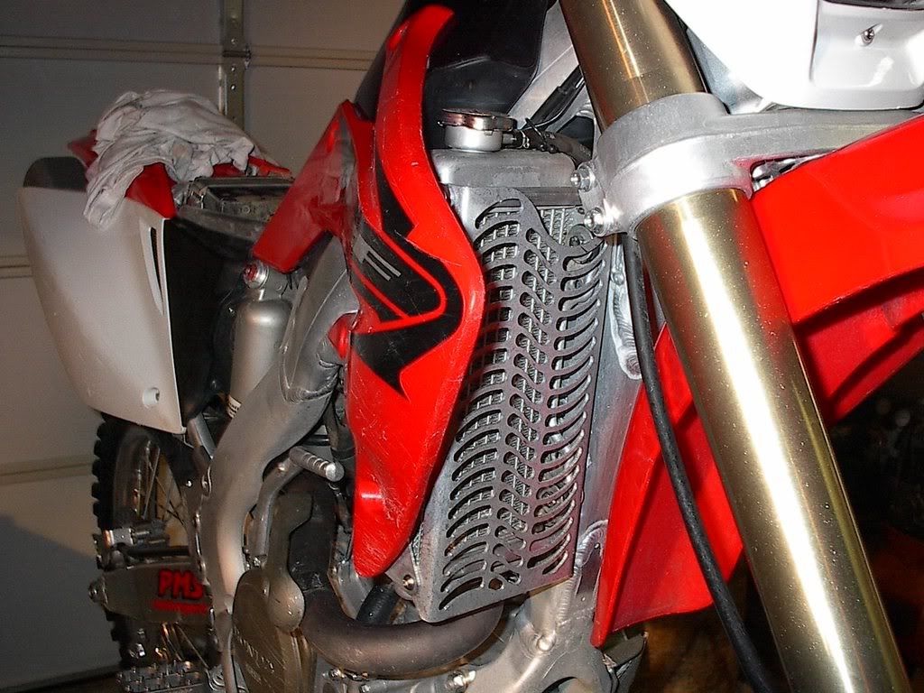

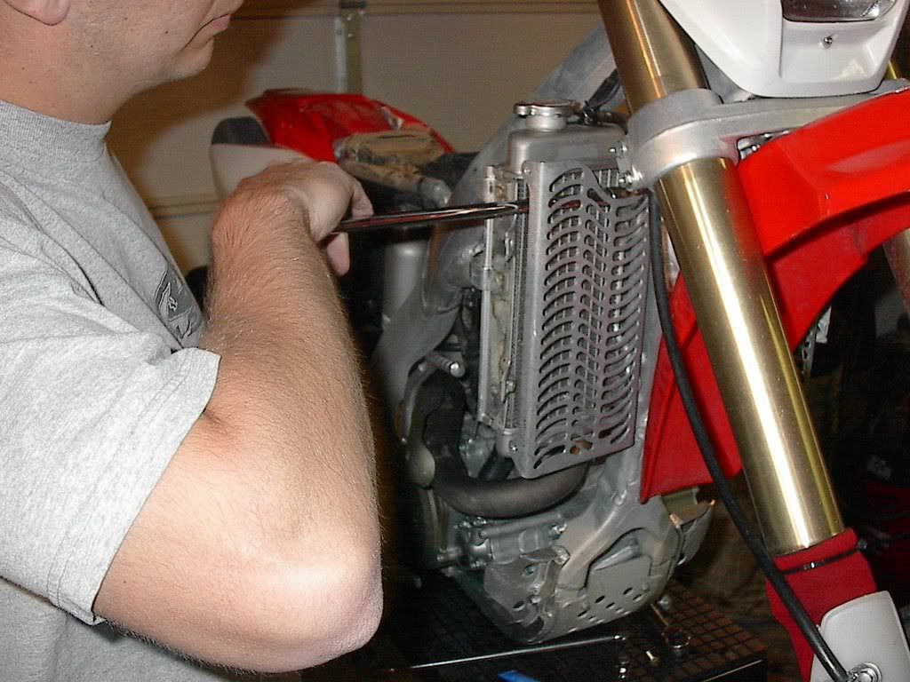

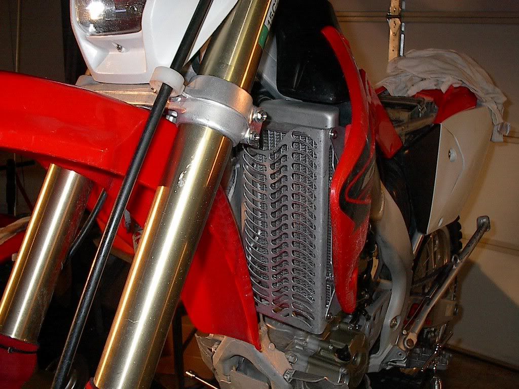

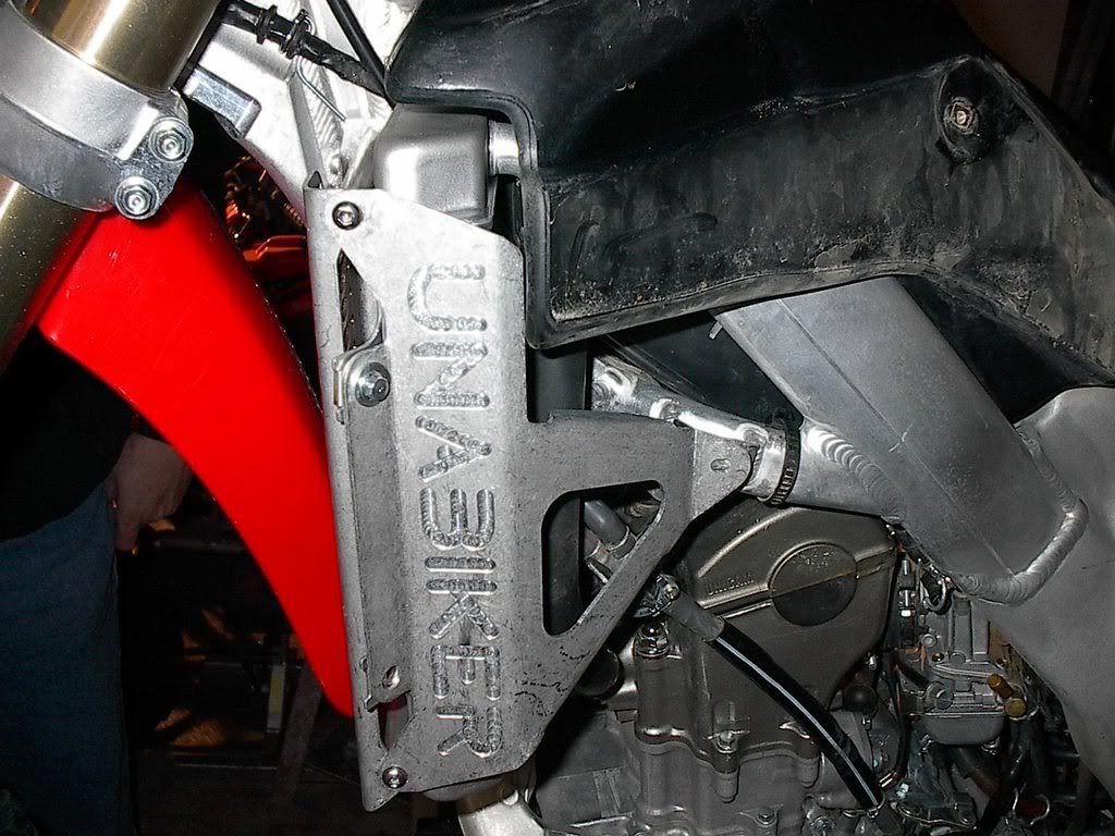

    -Next is start mounting the front rooster guard of the UNABIKERS..
    ...and then the UNABIKER braces an you should be looking like this...

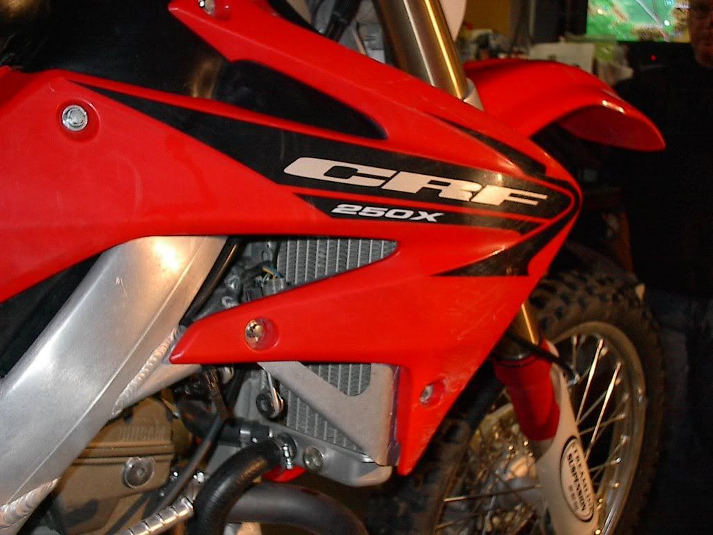

    -Your then ready to slap your tank and shrouds back on thinking your just about done!!
    -Anyone catch the problem?

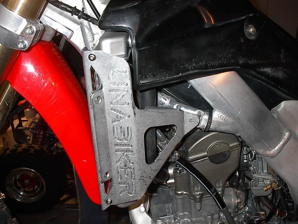

    -Yeah, the gas tank on the braces, thats the last thing I want rubbing a hole into is my $200 gas tank!

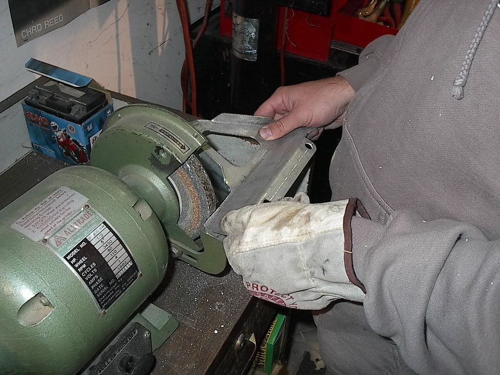

    -I love grinding these P.O.S UNABIKERS!! I would have been pissed if I had the anodized set.
    -We then went back and mounted them up to check clearences...
    -Slapped the tank back on, shrouds on the left side, and then shrouds on the right side and then ANOTHER FREAKIN' ISSUE....
    -Aux. cooling fan supports were in the way... Not no more!!
    -Now mounted up and ready to rock, literally!!

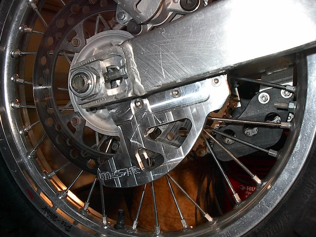

    Heres a picture of the MSR rear disc guard I also installed to replace the plastic 'guard'
