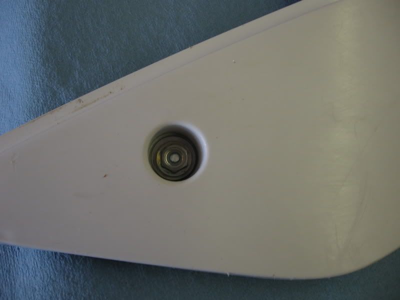

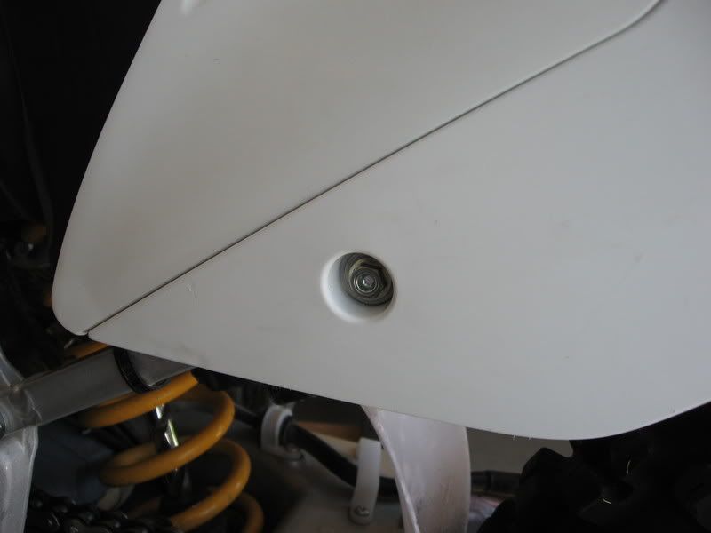

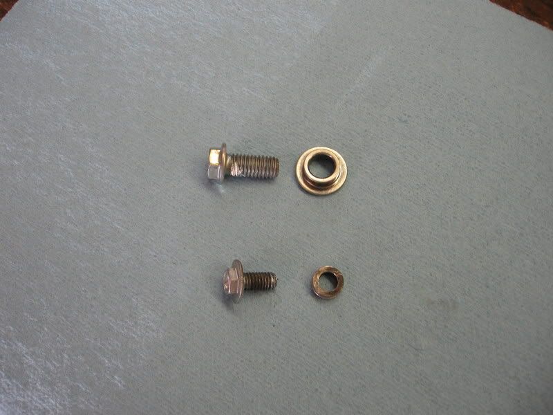

    The original 4mm screws mounting the sidepanels are too small, and can strip out {with no help}, and actually fall out on the trail/track, as my right screw had done previously. 8mm screws are the correct choice.
    Now I swap out the left sidepanel's screw while I have the panel off for the rear fender replacement.

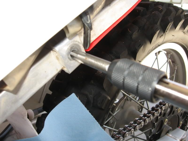

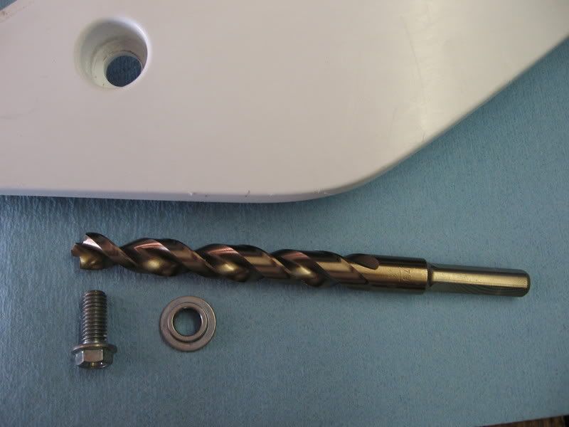

    Knock out the aluminum bushing from the reccessed hole, and use a 31/64" drill to open the hole. Install the new bush/washer firmly in the hole. New bush/washer and screw, are the seat mount parts from a crf250r.
    Drill out threaded hole in subframe with a 1/4" drill bit, tap new threads with a M8x1.25 thread tap,
    Lightly grease, or threadlock new 8mm screw, and mount sidepanel, you will FEEL the diference in screw strength,
