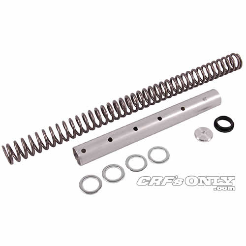

    Almost finished with all my mods to this bike, but I can tell you that the Race Tech front suspension kit sold here on CRF'sOnly was a HUGE addition to this RALLY bike. Adding the front fork spring and spacer (and Rebound Spring) to the LEFT fork, equalizes the suspension up front, and makes for a MUCH better trail bike. For those of you that are not aware...the CRF250-L...and RALLY bikes only have a spring and rebound spring in the RIGHT fork leg, from the factory. I upgraded my bike, thanks to parts from CRFsOnly, and am as happy as a clam at high tide.

    Excellent post and details about your CRF250L Rally Modifications! Here's some links to the spring kit and the seat you referenced.
    https://www.crfsonly.com/catalog/produc ... ts_id/6428
    https://www.crfsonly.com/catalog/produc ... ts_id/6296

    Ken, all of the parts you have listed above are direct drop-in replacements for the OEM parts...all fit very nicely.
    There IS an issue with the Rally side stand being too long, and others are now noticing it, and willing to acknowledge it, on other forums. I may have been the first to replace my Rally side stand with one from a 2017 CRF250-L, but others have followed suit. Simple replacement, however.....one must also order the side stand SPRINGS from the CRF250-L, or....as I did...modify the Rally springs to work on the CRF250-L side stand.
    Really liking this new Race Tech front suspension kit installed in the LEFT fork leg, along with that Rebound Spring you and I talked about. Did another 100 miles of trails this past weekend, and it handles the bumps SO much better than stock suspension, and for VERY low cost. :D

    HeidiHo...excellent feedback. Sounds like the Race Tech spring kit with the rebound spring is working great and is a must have for Rally owners. Here's a link to it for those wondering what we are talking about:
    Keep in mind this is NOT the standard Race Tech spring kit. CRF's Only includes a rebound spring for improved function and proper fitment of the primary spring.
