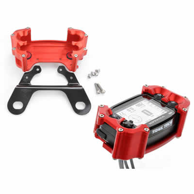

    we do sell the billet protector...however, don't have them in stock currently. we were supposed to have them today but trail tech found an issue with the external antenna. so they are hoping to ship them by the end of the week. so early next week i hope to have them in stock.
    by crfsonly » Tue Jul 19, 2011 2:59 pm
    We have the Voyager Billet Protector in stock in limited quantities now. Both red and black.
    http://www.crfsonly.com/catalog/product ... ts_id/4261
