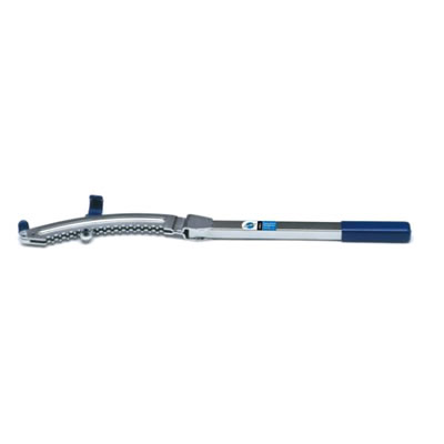

    by crfsonly » Sat Feb 17, 2007 5:40 pm
    there is a tool that can help:
    http://www.crfsonly.com/catalog/product ... ts_id/1915
    if you are reasonably skilled with a welder, or even with hand/power tools, you could make something similar.
