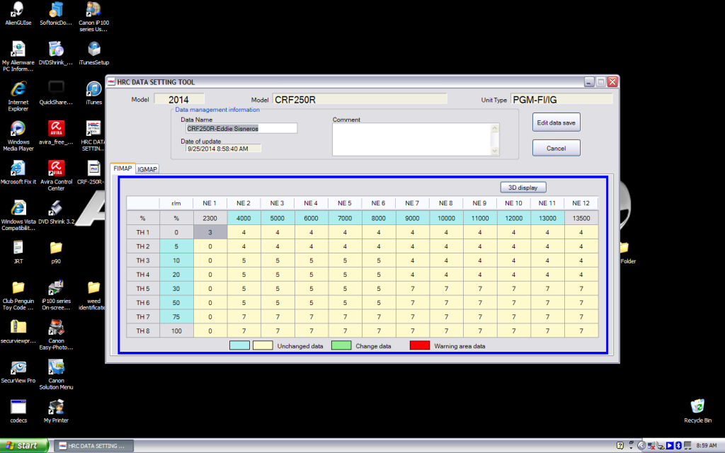

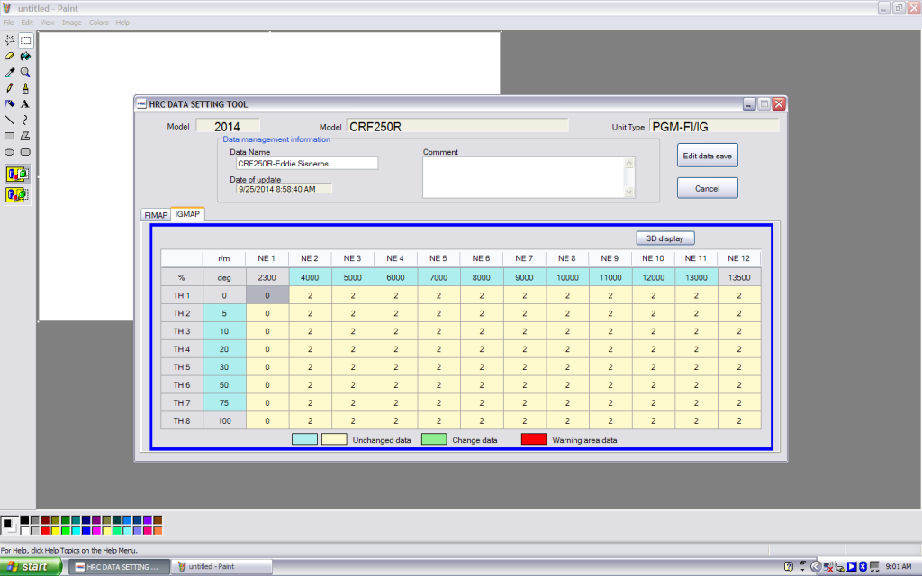

    I would like a to start a thread for comparing maps. I sent my ECU off to get remapped awhile back and I just recently purchased HRC tuning software and tool. If you pm me I can send you the fsd file if you would like it. Below are the screenshots of the setting changes.
    I had my ECU remapped for the following modifications on my bike
    2014 CRF250r
    Dual Yoshi pipes
    Back fire screen removed
