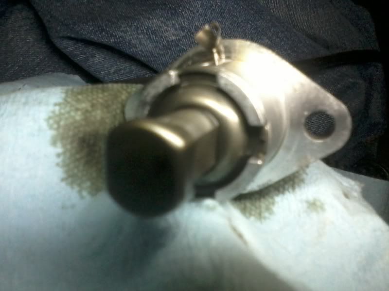

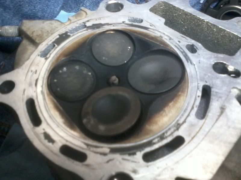

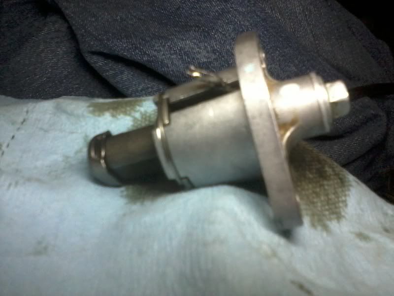

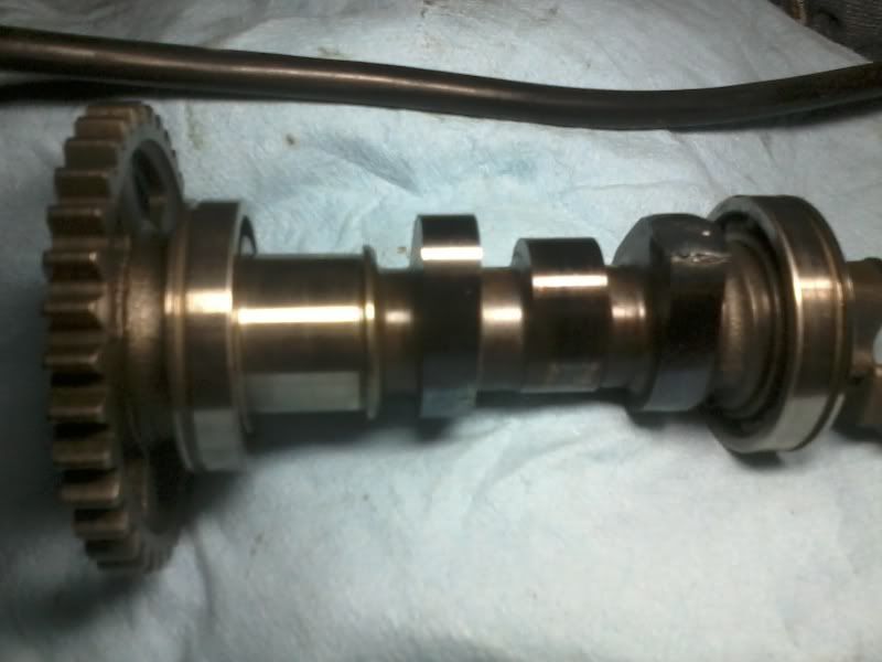

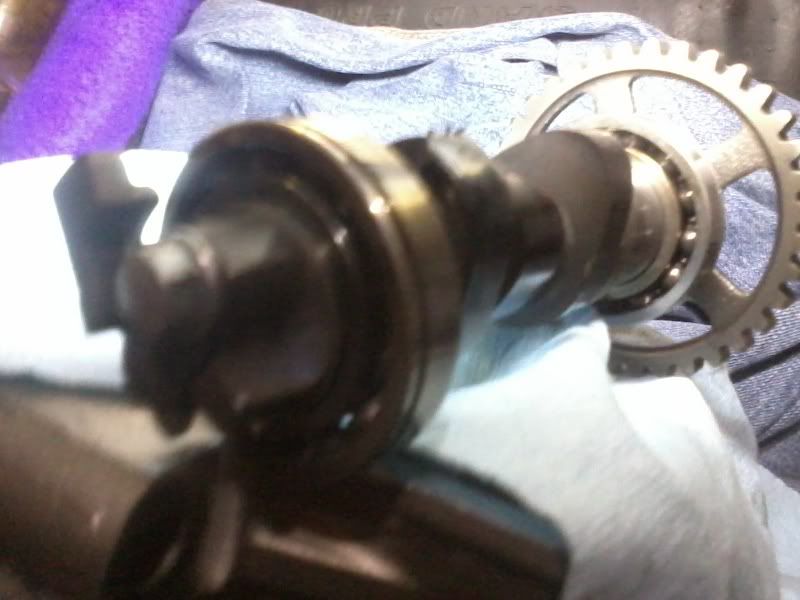

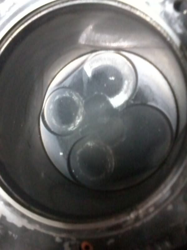

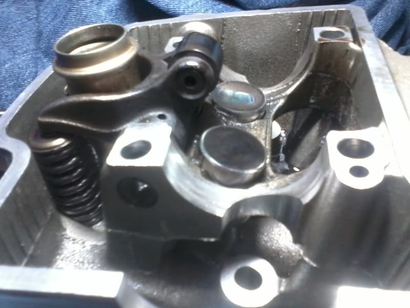

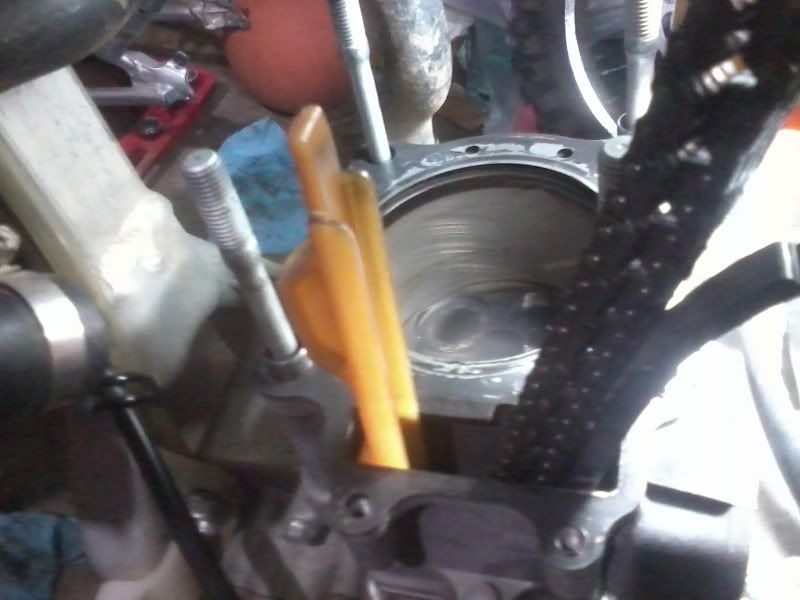

    OK if i can get these pictures on hear you will see the buckets of the intake valves; the one on the right seems to be jammed in real good i have not tried with pliers yet to get it out.
    The left one i was able to pull out relatively easy.
    The Cam Shaft seems to be in good condition except for the right side also, the lobe seems charred and warped and flattened.
    The little bolt looking part is the cam chain tension er. I was just wondering if yall would recommend me replacing that and if i really need to. The only thing that is wrong with it is the loose-metal piece got pried up and sort of broke.
    The bottom part of the valves seem ok except for the 'right' intake valve is stuck open and i'm guessing its due to the 'valve bucket' being stuck?
    The top portion of the cylinder doesn't have any scratches or grinds so im guessing the piston rings didn't corrode? And the piston itself seems fine except for the 'right side where the intake valve' sits it seems like it hit hard and indented the metal.
    [/img]SORRY FOR SUCH A LONG REPORT.
    SO I TOOK THE HEAD CAM AND TENSIONER TO MY LOCAL CYCLE SHOP AND THEY SAID THE HEAD WAS JUNK BECAUSE MOST LIKLEY THE RIGHT BUCKET DAMAGED THE HOLE IT SITS IN. ALSO THAT THE CAMSHAFT WAS CRAP BECAUSE OF THE LOBE. AND THAT THE TENSION ER I SHOULD REPLACE WHILE IM AT IT.
    I know mechanics will sometimes say your parts are not salvageable so that they can sell you parts and also get work out of it so i just want more advice and i will also be taking the head to other shops.
    That being said, im thinking of splitting the bottom end of the engine to see if any bearings gave out due to the starvation of oil but i dont see a how-to article about splitting the bottom end??
    [b]ANY HELP IS APPRECIATED.

    by crfsonly » Tue Aug 14, 2012 11:30 pm
    i too would recommend replacing the head, valves, shim buckets, cam, cam chain, cam chain tensioner and piston. you will need to make sure the bottom end isn't also damaged. you'll need to inspect the entire cam chain tensioner assembly to make sure there's no damage to other components. also inspect the rocker arm assembly. it's unlikely this was damaged but it should be inspected carefully. the roller should spin true and freely. the rocker pivot pin should be true/unbent. the rocker arms unbent. if you are looking for a source for these parts check out our OEM parts website at www.yeltrik.com. in crfsonly.com we have assembled heads with valves installed with CNC improved valve seats and port bowls. let us know if we can help answer any questions about your rebuild.
