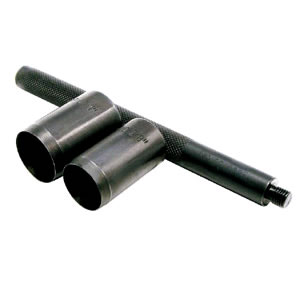

    by crfsonly » Thu Jun 21, 2012 8:19 pm
    motion pro makes this fancy tool for the job:
    http://www.crfsonly.com/catalog/product ... ts_id/1738
    makes perfect cuts every time. the other methods mentioned work too. on the throttle size, the main thing is not to cut off the entire end. just cut enough to get the insert through without dragging on it when twisting the throttle. you want some coverage of the end of the throttle tube to keep out dirt and grime.
