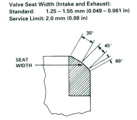

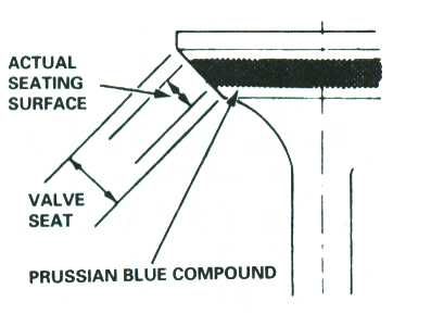

    by 124 » Tue May 29, 2012 7:04 am
    Garon wrote:Great diagnostic information. When the valves/springs are replaced, are the 'seats' replaced or is that just referring to a location of where the valve sits for the 2004 CRF250? I was unable to locate 'seats' in the parts section and thought maybe the valve head location was machined into the head to fit the valve nicely.
    And it sound like these 'internet experts' know their stuff as much as any mechanic I have come across! Thanks again for taking the time to help this budding mechanic! :)
    Sorry for the delay, I've been out of town for the weekend.
    The seats are integral to the head as an assembly. A shop can replace the seats separately but Honda will only sell you a head. It's basically cheaper and easier just to buy a new head anyway...
    It is rare to have to replace the seat. When its time to service the valves, the seats are typically "cut" to return them to spec. The worn portions of the seat are ground to specific angles. This is a random picture I stole from the web (ignore the numbers). You can see the relationship between the valve and seat...
