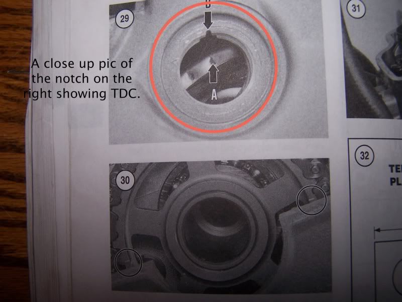

    by dirtae » Fri Apr 06, 2012 5:43 pm
    Loganm wrote:Yeah I did check the flywheel, and idk it seemed to me like it was turned forward a bit. But then when I took the cover off I saw two marks on it instead of just one.
    There are two marks on the flywheel, I believe one is for ignition timing and the other indicates TDC.
    Notch on the right indicates TDC

    Ok so everything I've read says that when the cam's set at TDC that the cam lobes should be facing the rear of the bike. Which mine does, so I don't think that the gear spun. Idk if anyone can confirm this, but the lobes are sitting pretty parallel to the rest of the head when it's at TDC.

    Ok, redid the valve timing AGAIN today. Except this time what I did was I stuck a bolt down into the cylinder through the spark plug hole to find TDC, then confirmed it with the marks. It turns out I might have been 2 teeth off. Also made sure my clearances were alright AGAIN.
