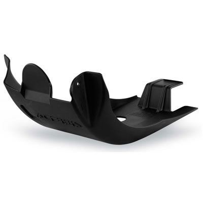

    if plastic type is of interest the Acerbis version is excellent. doesn't use zip ties so it's a more substantial mounting.

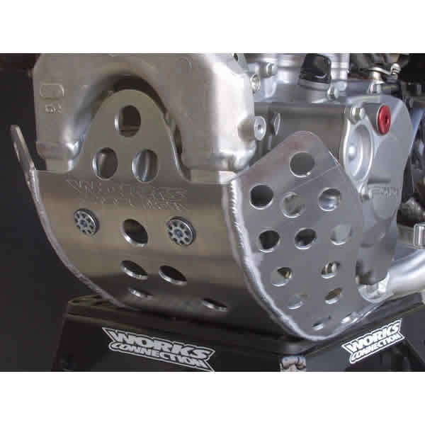

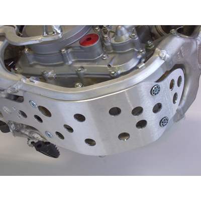

    works connection makes both a standard glide plate and an extended coverage plate. the standard glide plate doesn't reflect as much engine noise at the extended coverage. the new mounting system helps reduce this as well.:
    http://www.crfsonly.com/catalog/product ... ts_id/3481
    http://www.crfsonly.com/catalog/product ... ts_id/4351

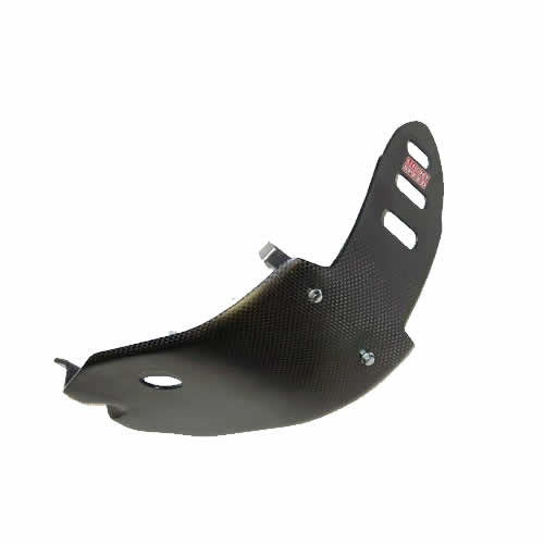

    lightspeed glideplate is light and provides excellent coverage. some report the carbon is brittle but others swear it can take any beating without damage.

    I've seen some images for the WC glide plate with out the holes. Is that because they are bike specific? I would think the holes would make it a little lighter and reduce noise. Does the image you show with the holes have the rubber isolator mounting system and fit the 2012 250r? Supposedly, these rubber mounts solve the frame flex issue (per Dirt Rider)
    http://www.dirtrider.com/drtested/141_1 ... index.html
    by crfsonly » Thu Jan 05, 2012 10:34 am
    yes...the 2012 WC skid plates have their Rubber Isolator Mounting System (RIMS).

    I have the Acerbis on my X and have been more than pleased with the application, ease of removal, and overall protection it provides. Just make sure if you order the Acerbis you get the one specified for the 2012, the 2011 does not fit......trust me!

    I do like the Acerbis because of it being light plastic. I had the Hyde racing skid plate on my X and it seemed bullet proof. However, mud would really pack up between the skid plate and the case. I like the look of the slimmer glide plate (like the Works Connection) for the R and hopefully it will be enough protection for the track.

    i have the moose e-line carbon fiber on 250r. i have never ridin it without the plate because i race hare scrambles and am constantly jumping rocks and logs so i am not sure on noise here. i was unsure of the carbon fibers strength. i have definately knocked it hard more than a couple times and it is holding. no cracks no splintering. they look pretty trick too. i also have the WC full wrap on my 250x which did make a noticeable noise increase due to the fact that it is a solid peice not like the plates for the r. my buddy has the 2010 250r full wrap and it so far has held up great with little noticeable noise increase. keep this in mind that once the aluminum "bends" or "dents" it will remain in place. the carbon fiber however will flex and return to position.
