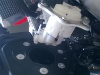

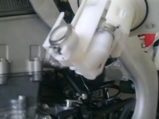

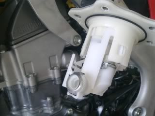

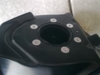

    by dabrowski » Mon Feb 15, 2010 1:57 am
    thought i would post some pics of the fuel pump, and pickup from the fuel tank for anyone interested
