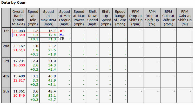

    This table shows speed and RPM data for each gear. Fields without results is a result of data not being provided necessary to perform the calculations.
    #3 Shows the stock (current) final drive gearing speed and RPM data.
    #4 Shows the comparison final drive gearing speed and RPM data.
    #5 Shows the change between the stock and comparison final drive gearing.
