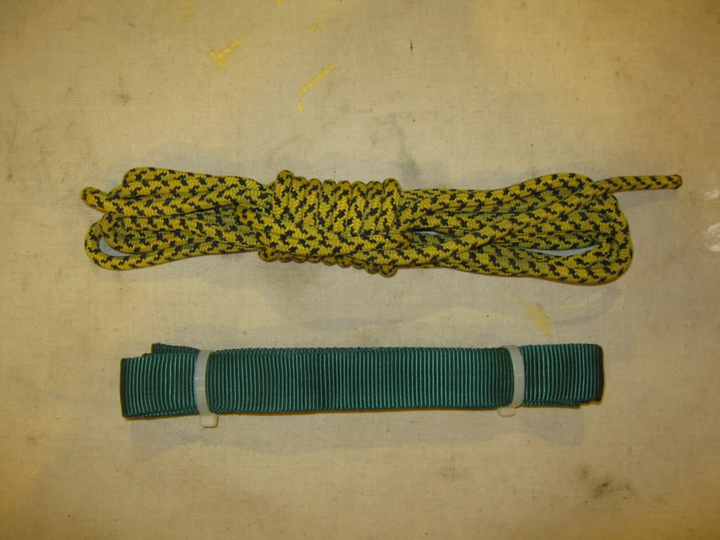

    Stuff you will need.
    15 feet of 1/4 inch rope. You can find the rope in most sporting goods stores.
    Minimum of 6'6" of 1inch flat webbing. Each bike will be different depending on seat height and sag.
    Duct tape or electrical tape.
    Handlebar soft ties
    The 1 inch webbing goes over the seat and is tied to each foot peg. Do not leave a long tail of webbing on the left side of the bike next to the front sprocket.
    1/4" rope is tied to the 1" webbing and will run down the longitudinal axis of the bike.
    The duct tape will keep the rope on-top of the rear finder and out of your rear sprocket.
    Run the rope back to the soft ties on the bike being towed. The rope needs to go through the loops twice and then wrap once around the throttle. If the rider being towed starts to fall have him let go of the rope (throttle) and the whole thing will unwrap.
