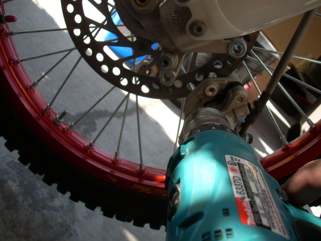

    Do it yourself. Not hard, just take your time and follow instructions.

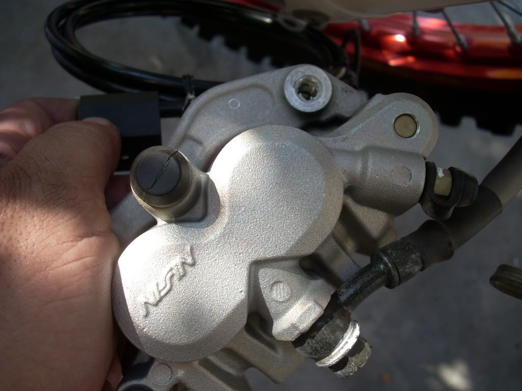

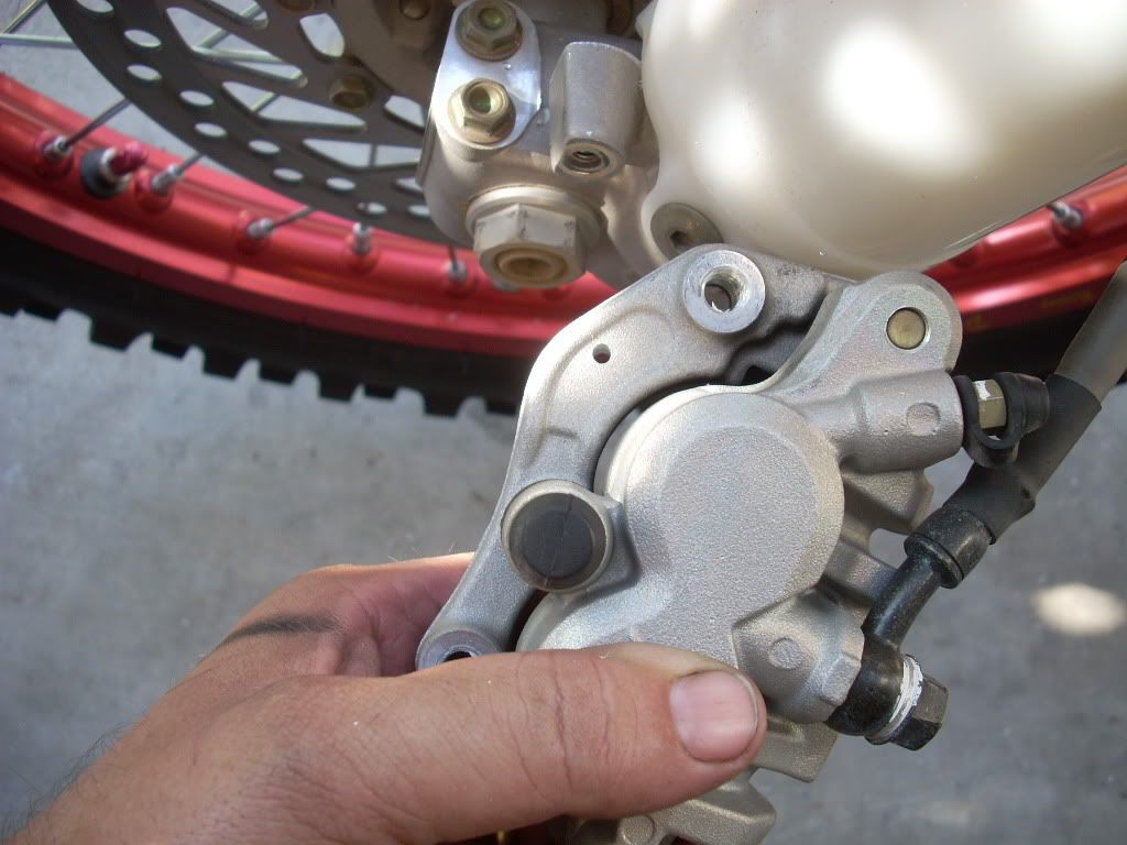

    I've pictures of all the steps, just haven't had the time to put together a "How To" yet.

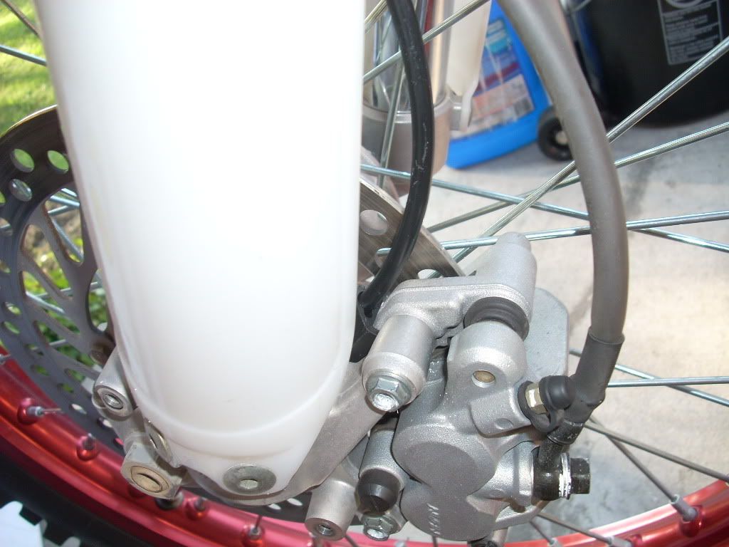

    Hardest thing was drilling the hole in the caliper to install the magnetic sensor. Not that difficult.
    Caliper: Determine placement.
    Scribe the hole.
    Drill the hole.
    Admire the hole.

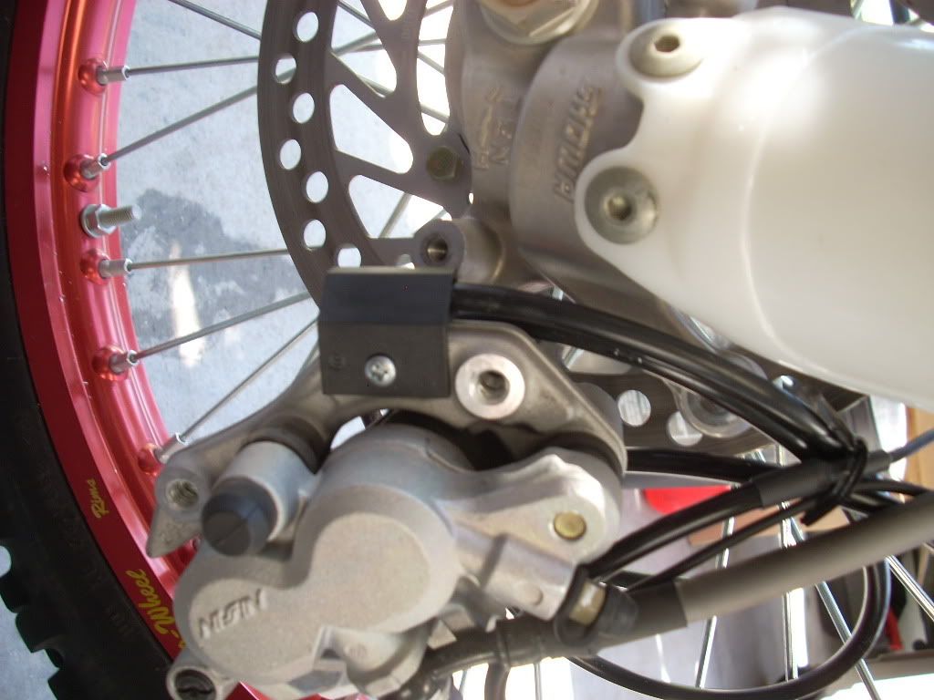

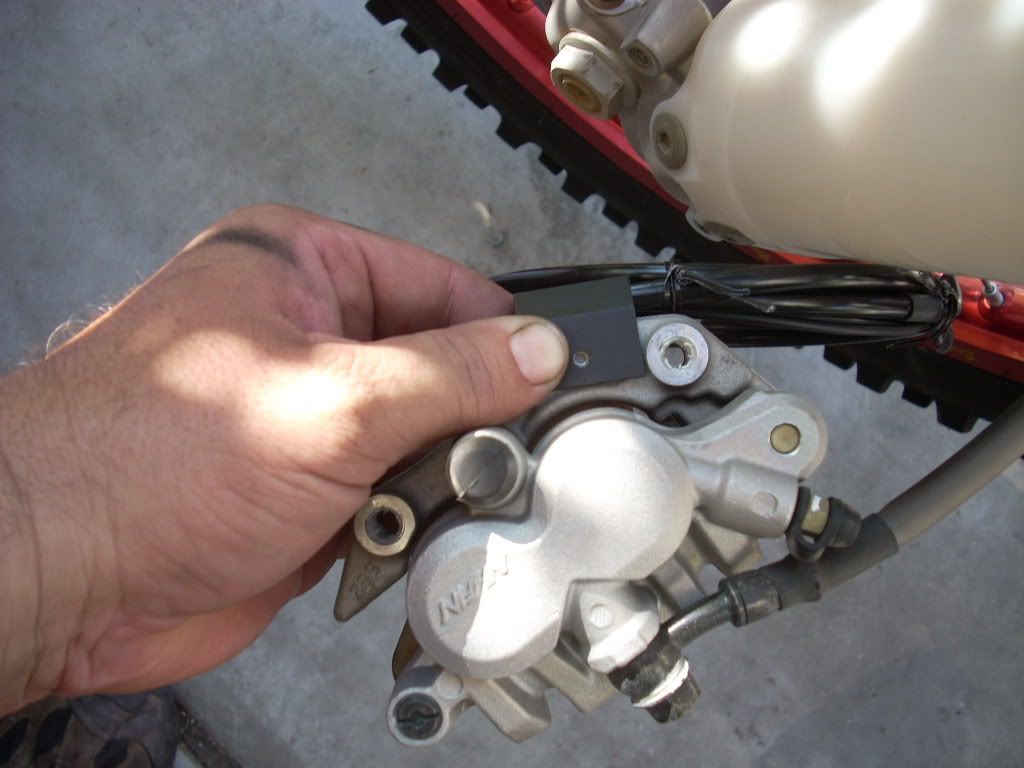

    Mount sensor.
    Reinstall caliper.

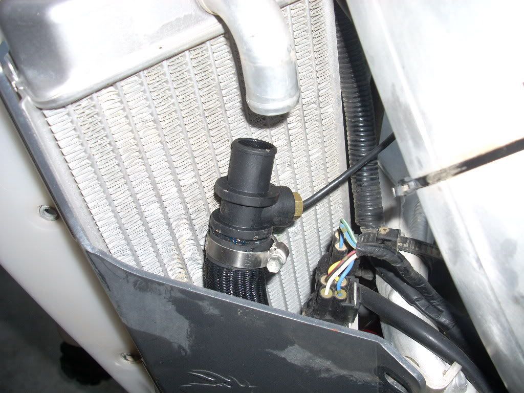

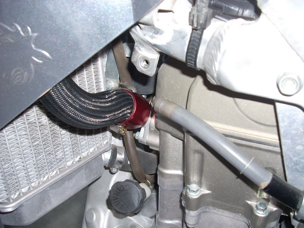

    Left Radiator hose (after draining coolant) is removed.
    3/4" of the hose is removed about 2/3 of the way up the hose. Install sensor.
    Install remaining hose.

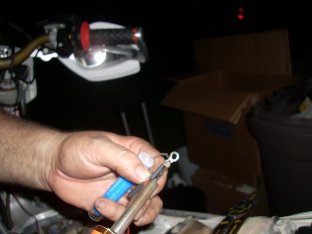

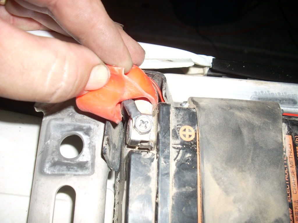

    Main power to battery. I like to solder all connections and use heat shrink tubing for a trustworthy connection.
    Connect to battery.
    Do the same with the ground connection.
