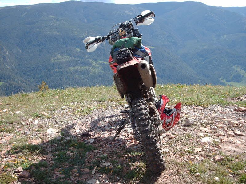

    by Caballo Rojo » Sat Jun 30, 2007 9:40 pm
    Been riding single track in the Bridger Forest in Montana. Note the silver (camo) end cap!
    Almost got taken out by a very large elk while movin' along in fourth gear. Then came around another corner and scared up a black bear sunning himself in the middle of the road. Baja is exciting but this is frightning!
