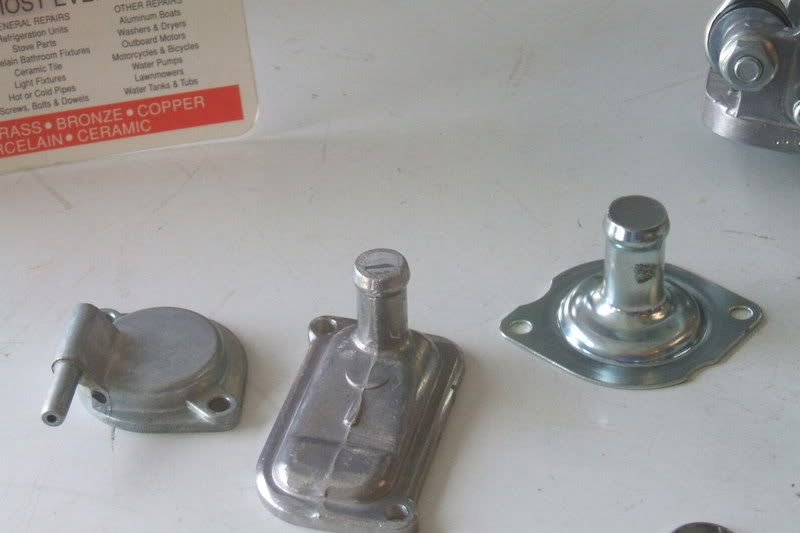

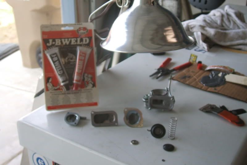

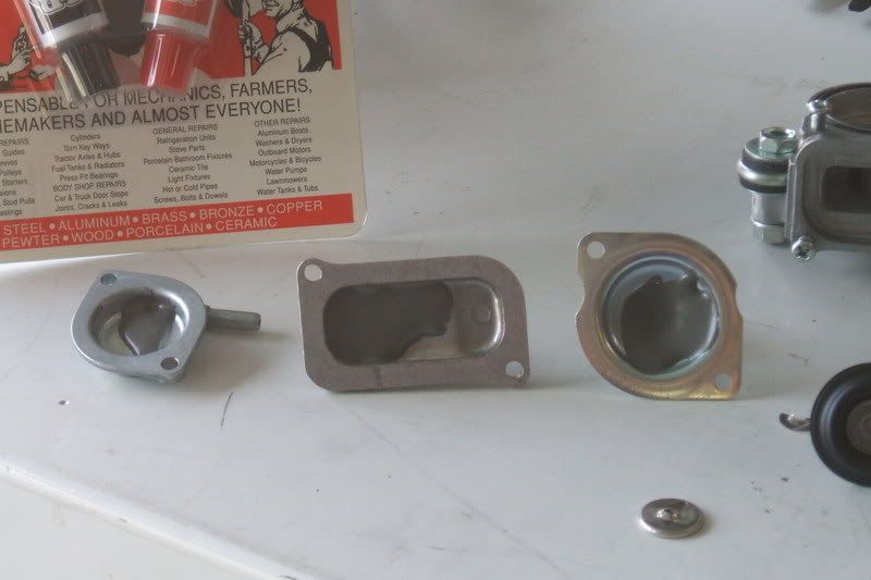

    Well here is my Smog block off kit. It works great,and got rid of all my decel pop. I should not have any problems with the rangers either.
    I took the Pics after i Disassembled the pump but it is pretty easy to do. I removed all the guts and put tape over the holes and filled with JB Weld. I used a heat lamp but it is not necessary. I have had it done for about 6 months now and it has been working great with no issues.
