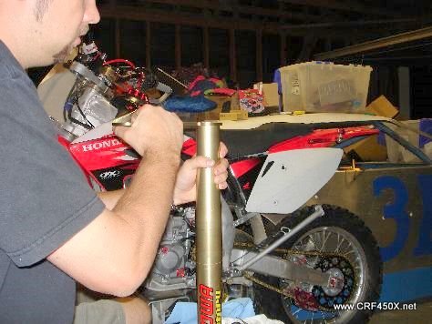

    Remove your front
    wheel and brake caliper.

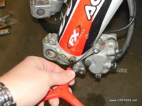

    Remove your lower
    fork protectors.

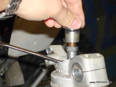

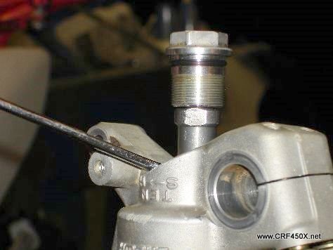

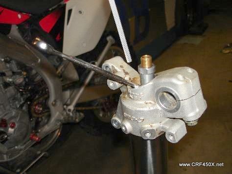

    Loosen your upper
    and lower triple clamps and lower the fork down so you can
    place the fork wrench between the triple clamp and the fork. Tighten the lower
    clamp lightly to hold the fork tube while you loosen it. Once you've loosened
    the
    top cap, remove the fork.

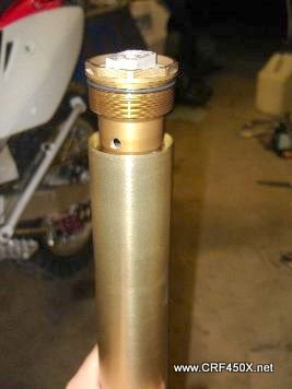

    Hold the outer fork
    tube and completely loosen the fork cap.
    Slide the outer
    tube down from the fork cap.

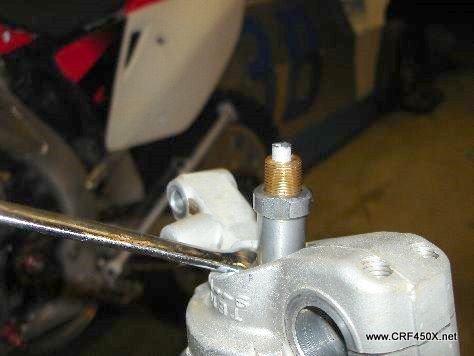

    Remove the air bleed
    screw on the fork cap.

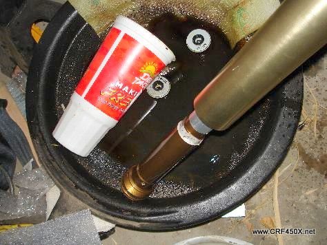

    Drain the forks
    completely. See your owners manual page 87 for how much
    fluid will remain after you have drained the forks.

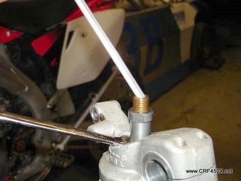

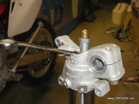

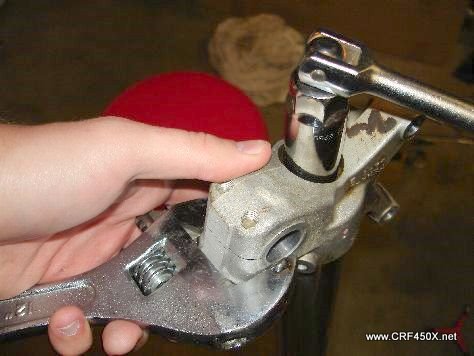

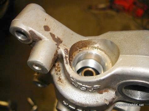

    Flip the fork over,
    you'll be loosening this bolt The fork center bolt.

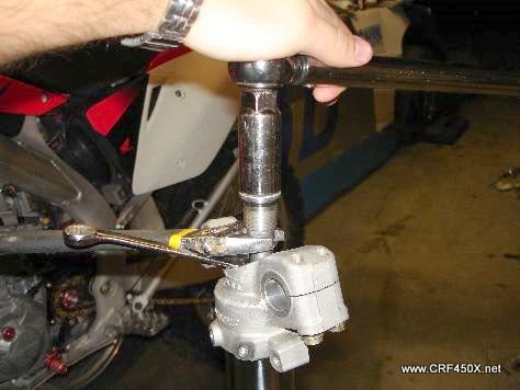

    We used a breaker
    bar and a crescent wrench to hold the fork foot in place.
    Once the bolt is
    loose, press down on the fork leg and the inner rod will come out of
    the fork. Place a 10mm wrench around the tube between the foot and the center
    bolt to keep it up and in place.

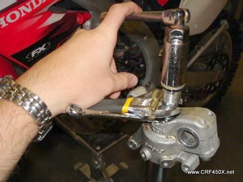

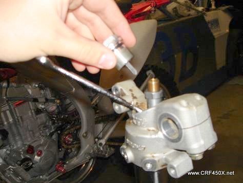

    Place a wrench on
    the lock nut and a socket on the fork center bolt.
    Remove the fork
    center bolt.

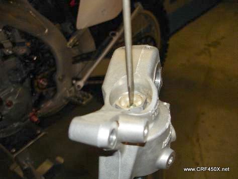

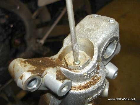

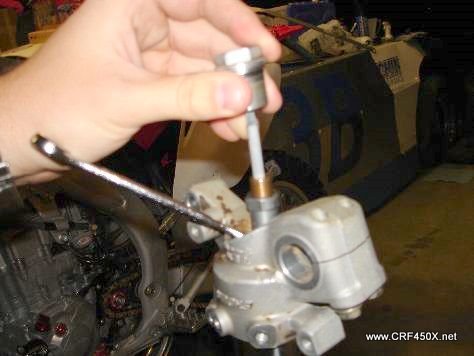

    Use the fork center
    bolt to remove the rod down in the fork. Slightly twise the fork
    to remove the rebound adjustment rod.
    Completely remove
    the rod.
    Here's the rod and
    adjuster.

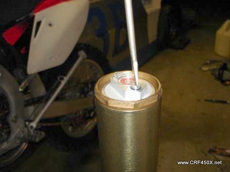

    Remove the wrench
    and let the rod slide back into the fork leg.

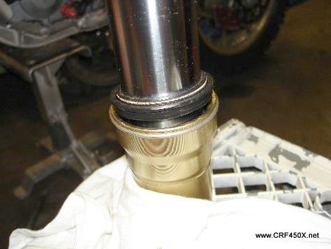

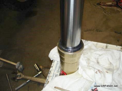

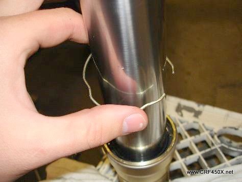

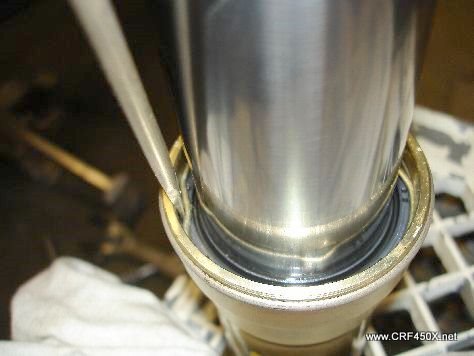

    Use a screw driver
    to pry the dust seal from the upper fork tube.
    Completely slide
    up the dust seal.
    Use a screw driver
    to remove retaining ring.

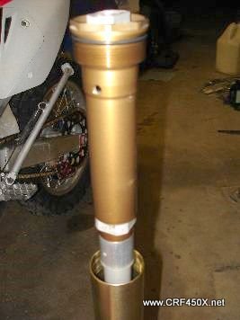

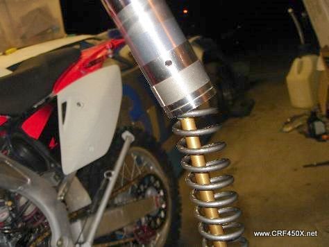

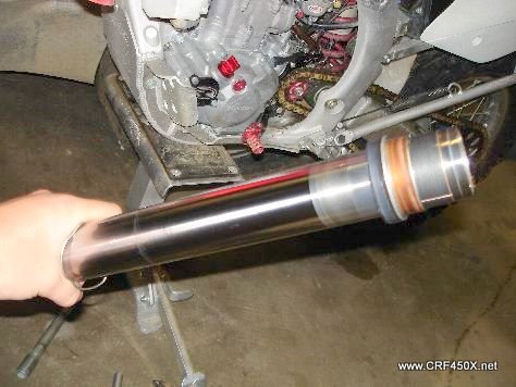

    Now grab the lower
    fork leg in one hand and the upper fork leg in the other.
    Collapse the tube and pull them apart in the same fashion as a slide hammer.
    The lower fork leg will come loose (it makes a mess so be prepared).
    Place the spring back into the upper fork tube. This is what you'll now have.

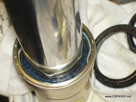

    Here's the lower
    fork tube with both the bushings, the washer and the seal.

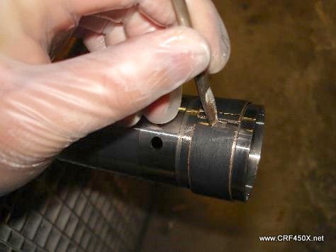

    Use a screwdriver
    to pry the upper bushing apart and remove it from the lower
    fork leg.
    Remove the lower
    bushing from the lower fork leg.
    Remove the washer
    Remove the seal
    Remove the retaining
    ring from the lower fork leg.

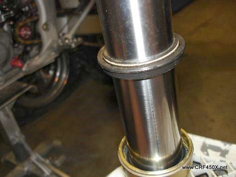

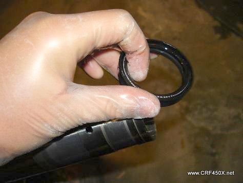

    Remove the dust
    seal from the lower fork leg.

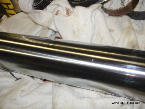

    Clean and check
    your lower fork leg for any problems. Any deep nicks can tear
    new seals. Here's a pretty good gouge on one, but we'll run it.

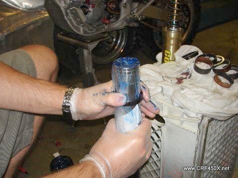

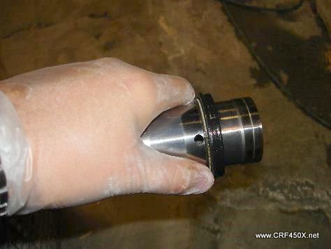

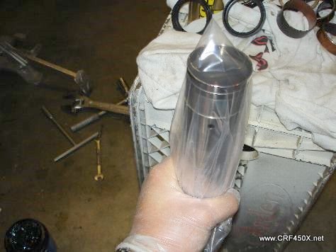

    Place a sandwich
    bag over the lower fork leg.
    Grease up the sandwich
    bag so you don't tear the seals as you put them on.
    Place the dust seal
    on first. Spring facing towards the bottom of the fork.
    Place the reatining
    ring on next followed by the fork seal. With the spring facing up
    part number facing down.

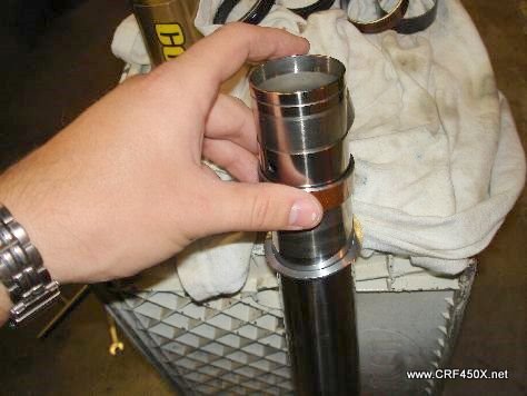

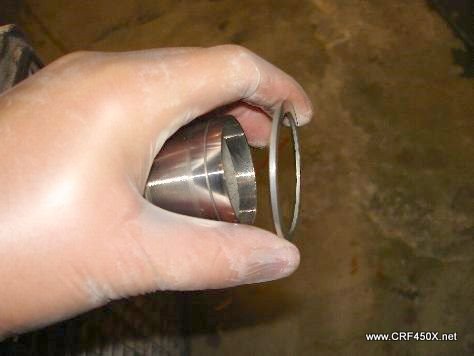

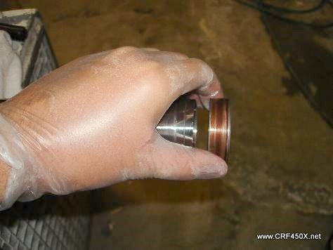

    Place the Lower
    bushing back into place. If your reusing your old bushing make
    sure to check the inside surface of this bearing. It's teflon coated and should
    be black
    with no silver or copper showing through it. If any of the surface isn't black
    the
    bushing should be replaced. Replace the upper fork bushing but inspecting it's
    outside surface.

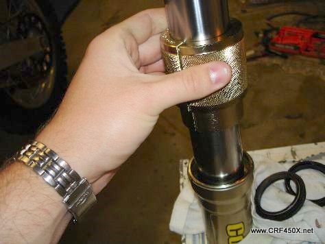

    Place the lower
    fork tube back over the spring into the upper fork tube. Slide
    the lower bushing back down into the upper fork tube.

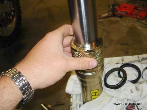

    Use the seal/bushing
    driver to press them back down into place again using a
    slide hammer motion. Not much pressure or force is needed for this.
    Make sure it's seated
    then lower down the washer into the upper fork tube.
    Press the fork seal
    back into place and use the fork/seal driver to ensure it's seated.

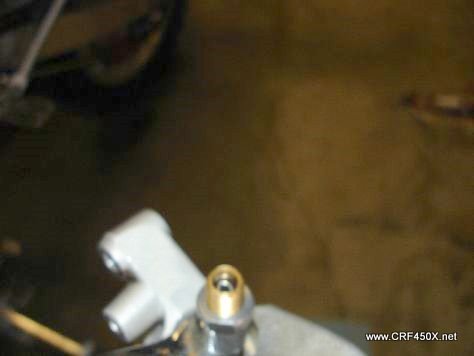

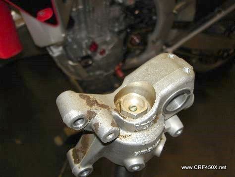

    Place the rebound
    adjustment rod back into place and ensure it's seated.
    If the rod is still
    visible its not seated. Use the fork center bolt to twist it and
    drop into place.
    The rod is properly
    seated in this photo.
    Screw the center
    fork bolt back into place. Tighten the bolt fully by hand.
    Check the clearance
    between the lock nut and the center bolt. The sepc should
    be 0.06-0.08 inches of clearance.
    Tighten the lock
    nut to the fork center bolt and torque to 16 Lbf-ft.

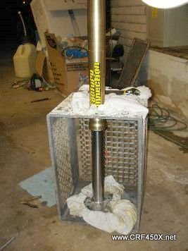

    Here's the milk
    crate I used as a fork older while working on the fork. A rag
    cushions the fork from the garage floor.

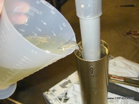

    Loosen the fork
    cap from the outer fork tube.
    Using a ratio-rate
    determine how much fluid you want in your fork. Subtract the
    amount of fluid left in your fork from the total volume you want (remember the
    chart
    above). We filled ours with 370ml of fluid as recommended in our Factory
    Connection suspenion owners manual. Stock is 338.
    Flip the fork over
    and pour the fluid into the fork.
