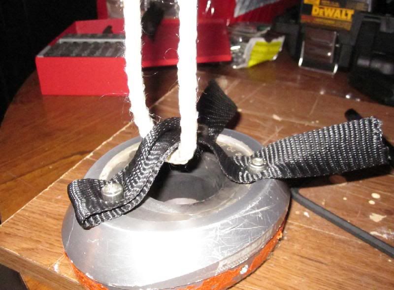

    When repacking your exhaust, if your Promotobillet endcap is stuck, you might want to try this method.
    Find some tiedown material and rig it up like this with the insert bolts. Make sure to melt the internal edges a bit so the material doesn't fray and rip. Put the rope around something stationary and pull on the can until it pops free.
