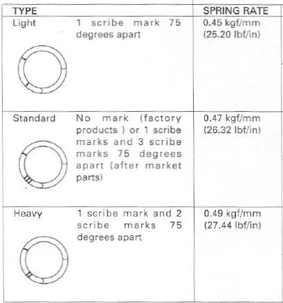

is it possible to determine the fork spring rate by markings on the spring itself?
how would you check to see if these fork springs,
http://cgi.ebay.com/ebaymotors/ws/eBayISAPI.dll?ViewItem&ssPageName=STRK:MEBIDX:IT&item=270262589320
are really .47 kg/mm? are they stamped somewhere?
