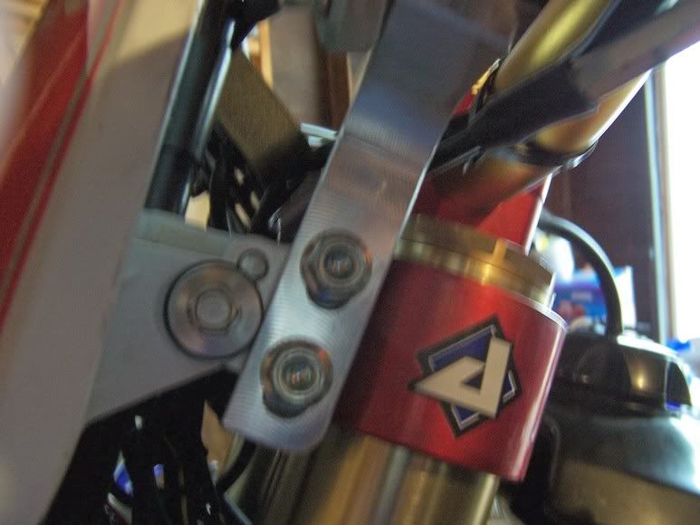

    by Trail Addict » Sat Jul 26, 2008 12:13 pm
    Here`s what I had to do.
    by [email protected] » Sat Nov 08, 2008 5:36 am
    if anyone else runs into this problem:
    You don't have to grind off anything.It's the same theory of mounting handguards that has perplexed so many. I've put that identical set-up on myself, and on my buddies 250X,Applied and BRP.
    The secret is you don't thread in the number/headlight plate in unless the triple clamp bolts are very loose,left side and right side.
    With them loose there's all kinds of play for the inner handguard , you have the triple clamp bolts started a few threads only. You then tighten all three alternatively until they are all cinched up,then torque the triple clamp bolts lastly.
    You can see that yup, it's a tight fit but fit they do.
