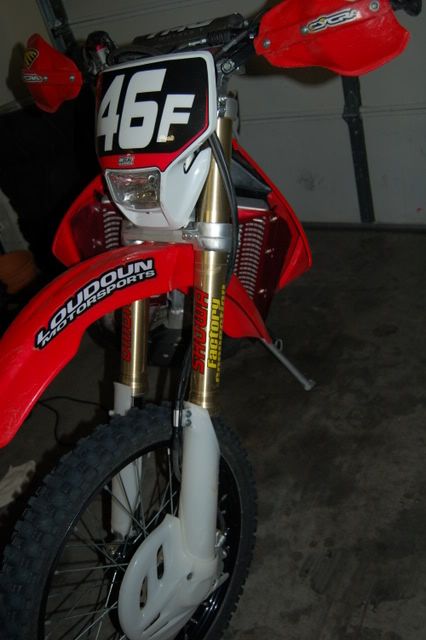

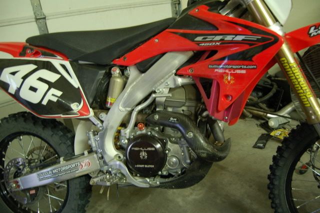

    Here we are, I know a couple of you guys wanted some more pics.
    Now I just have to update my "garage" with the mods!

    Beautiful!

    And it's dirty!

    Woah! Major brake line routing problems! :shock:
    both of those should be on the inside of the forkleg.
    nice looking bike though. love the numbers.

    Yep. The front brake line goes on the inside of the fork. It will get ripped off by brush. I did the same thing... :oops: :oops: :oops:

    Well damn. I'll fix it eventually.

    Ok, I've obviously got some routing issues...haha. We're a little twisty on our cables.
    I just put it like this for now, looks like I might have to disconnect some cables in order to get the proper routing.
    Here it is. :lol:

    You should be able to take your caliper off and rotate it around for proper cable routing. It is no big deal, easy to do. I have always liked that scoot!!
