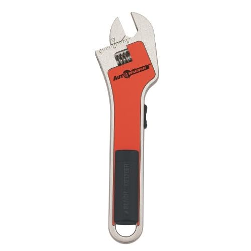

    BTW Do you use a Metric crescent wrench to work on that metric bike of yours?

    How else can you change out your muffler bearings?
    by Smash » Thu Dec 14, 2006 2:17 pm
    Actually I used to, but I recently moved to the power model....
