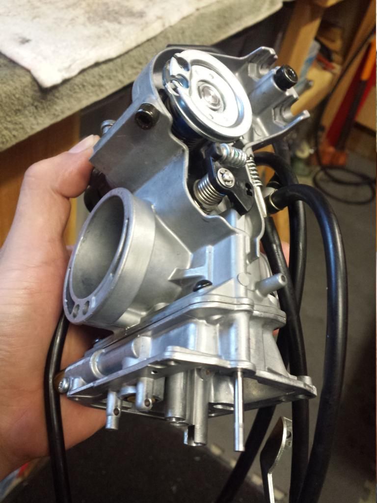

    As long as I don't do anything silly it will be mint :) Oooooh Awwwwe, so shiny and clean!
    I should post, "The List" when I'm done. That should make a lot of people clutch their wallets and scream in horror LOL :)

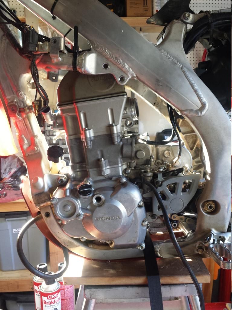

    Hey.... as I mentioned before you had to remove the motor to work on that carby anyway :) It looks soooooo shiny now ... wanna do mine? :)

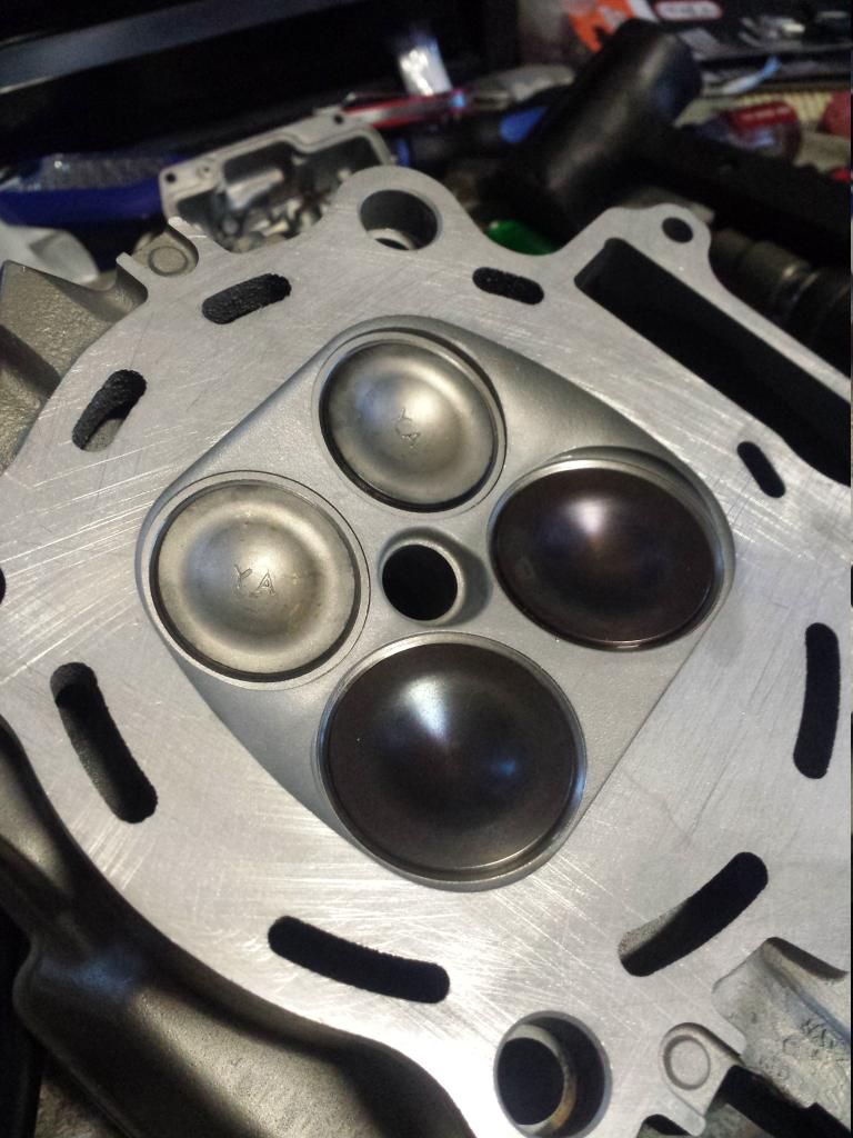

    <sniffle> It's so beautiful!
    The cylinder and head are back in my hands and are looking like brand new! This assembly is going to be awesome :)

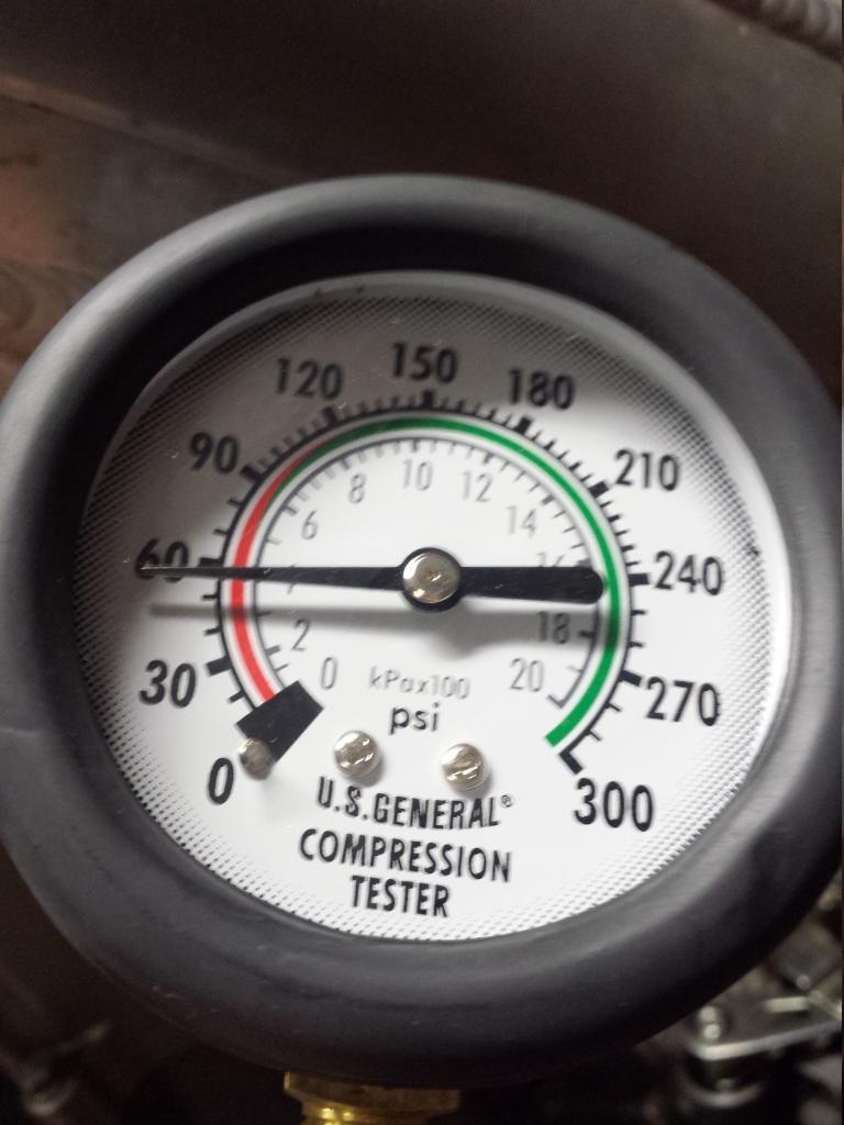

    I got the engine back together this weekend. Everything went exceptionally smooth. Man is shimming valves SO much easier on a work bench!
    I should be able to get enough of it put back together tonight to turn it over for a compression test. Very excited to ride this bike now :)
