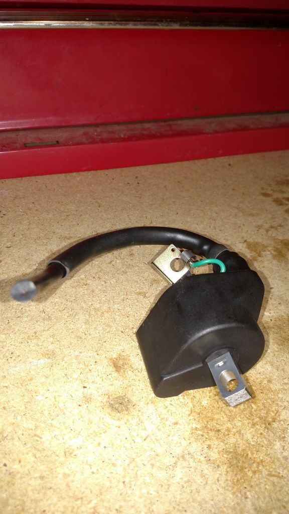

    Got the new coil today. Does the cap just pull off the old coil wire and push on the new one? I read somewhere there is a spring and resistor in there.. The end of the new coil wire has a tiny(1/4mm) hole.. do I strip the end or is there a tiny rod that links up with it?

    can you post a picture of the coil ??

    by 450%FASTER » Sat Apr 01, 2017 11:41 am
    2004 CRF450
    1987 SUPER MAGNA 700
    450%FASTER
    Joined:Wed Mar 22, 2017 1:10 pm
    Re: The dreaded no start..04 crf450r
    by 450%FASTER » Sat Apr 01, 2017 11:45 am
    2004 CRF450
    Posts:4406
    by JimDirt » Sun Apr 02, 2017 7:02 am
    In Photobucket , use the link "IMG" near the bottom of the list on the right and it will post the image directly as i have done
    As far as the cap goes , you should be able to unscrew the plug cap (counter clockwise) and then screw it on the new coil , just use some WD-40 or Carb Spray into the boot sleeve on the wire side if its sticking and wont twist off , and it should unscrew easily , then screw it back on (clockwise) to install it .... The resistor is in between the part that screws on and the part that attaches to the plug , so no worries damaging that
