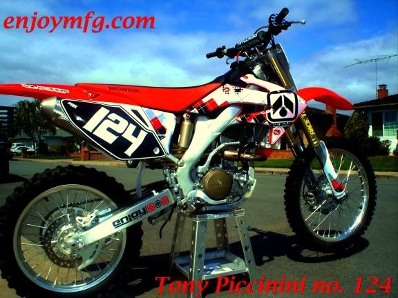

    i did all these mods b/c i live in cali and we have to deal with green sticker laws
    by Old Dude » Tue May 23, 2006 11:09 pm
    tpeach24,
    That looks really good. Did you use an OEM R seat cover after you shaved the seat foam? Doesn't it feel slim at the seat tank transition compared to the X? I have ridden mine with both tanks and there is a definite feeling of more weight up high with a full X tank. The narrower R tank makes getting way up on the tank a lot easier when going into corners too.
    I did a 30 mile loop at Georgetown with the smaller tank and had a liter and a half of gas left. I would not recommend trying a long desert run with the smaller tank though you might be pushing it. Literally!

    oh i still have the x tank on there but ive been looking to buy a r tank because i ride 50/50 track and trail and the rides i do arent long plus im going to race motocross this summer do you recommend?
    by Old Dude » Wed May 24, 2006 8:54 pm
    I strongly recommend the R tank if you are going to race MX. I got a spare OEM seat so that I had the option of switching back and for for long trail rides. The bike with the R configuration is, again, noticeably slimmer and lighter compared to an X with a full tank of gas.
    I would also suggest that you get a cam for it. My Stage 1 Hot Cam made a huge difference. If you don't do the install yourself have it done when you have your valve clearance checked. The cam was without a boubt the best performance mod value (after making it run right with the JD kit and Honda CCC air box mods) for the cost. Seriously, this thing revs better and pulls from the bottom to the top of the RPM range with the Hot Cam. I love this thing!

    ya ill probablly just buy an r tank off ebay oh and i already have the hotcam and ive done the pink wire mod, twin air filter , fmf pipe, smog block off kit, cccmods, ect.
