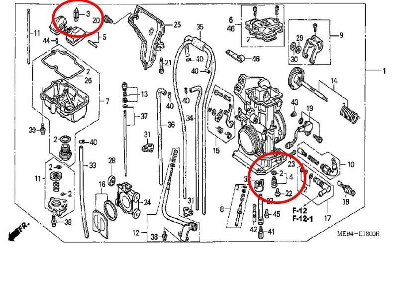

    the thing with the filled gas makes me a little bit worrie. there must be something wrong, i think.. what should i check, that this doesn´t happens to me any more? u told me to check "bad main needle and seat". that´s the needle at the bottom of the carburettor (sorry, don´t know the right expression, i looked in an online dictionary). how will i do that??
    by 124 » Thu Feb 22, 2007 11:48 am
    Changing your oil is never a bad thing...
    The main needle and seat (also called the "float valve set") is #3 (needle) and #4 (seat) in the pic below.
    When these go bad (and they do), the carb will "overflow" when the petcock is left open.

    yesterday i checked the main needle and seat, everything looked good. but what i did is bending the little piece of metal which "controls" if the main needle closes the valve. now the valve should close a little bit earlier.
    i reassembled everything and after some kicking it started. but now i have to think about testing if the gas-thing happens again. i thought i will demount the back part of the bike so that i can see the backside of the carburetor, then i´m gonna open the petcook and will see/wait if something gas will appear in the caburetor. maybe u have some other idea of how i can test the float??

    if you bent that little tab to close the needle sooner you will have screwed up your float hieght and you may find the beast starving for fuel under a good load with lots of throttle , I would personally go back and reset the float hieght to the correct spec . you probably only had a pc. of dirt get under the needle the one time and it flooded everything with gas . GO BACK AND RESET THE FLOAT HIEGHT TO CORRECT SPECS OR YOU"LL BE SORRY !
