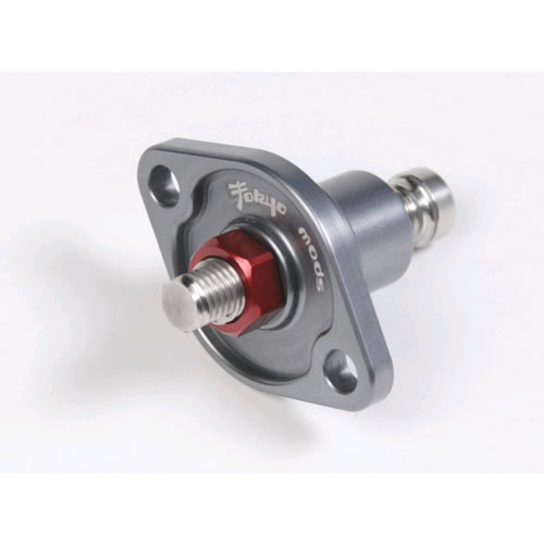

    you can also replace it with a mechanical cam chain tensioner:
    http://www.crfsonly.com/catalog/product ... ts_id/2052
  • Tater chips
    Joined:Fri Feb 02, 2007 10:37 pm
    by Tater chips » Fri Feb 02, 2007 10:46 pm
    i really like those...
