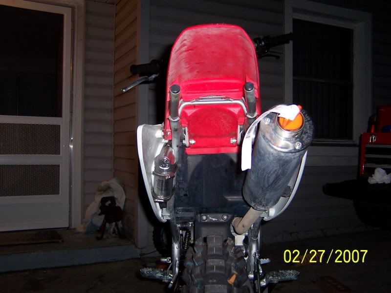

    by krisrtch » Tue Oct 06, 2009 4:34 pm
    I had the Works Performance Shock on mine and loved it but the 500 bone price tag kinda sucked.
    Here is pic of mine

    by krisrtch » Wed Oct 07, 2009 10:37 am
    Those where from a 91 (i think) RM250 the guy i got um from on ebay had already done all the mods to the steering stem. and the RM wheel came with the set.
