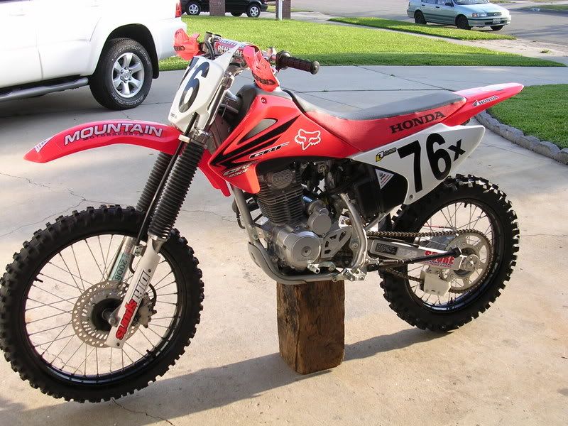

    Has anyone ever painted rims black. well i'm getting new black ones from excel,but i just wanted to know how it would look like before so i painted mines
    el baja
    Posts:174
    by el baja » Mon Apr 23, 2007 8:30 pm
    Image THIS IS HOW IT LOOKS....
    by Asmith » Mon Apr 23, 2007 9:09 pm
    Could've just posted a pic of your bike and one of us could've Photoshopped it for you. Alot less time, money and work.
    Looks good.

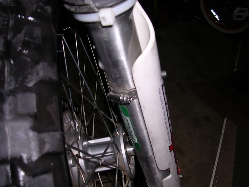

    I really like your fork guards do you recall what type they are and whre you picked them up?
    el baja
    Posts:174
    by el baja » Fri May 11, 2007 8:26 pm

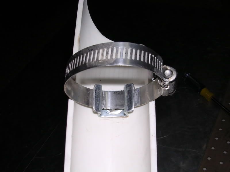

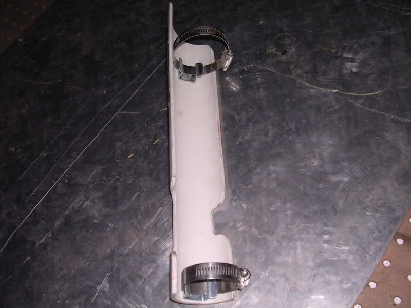

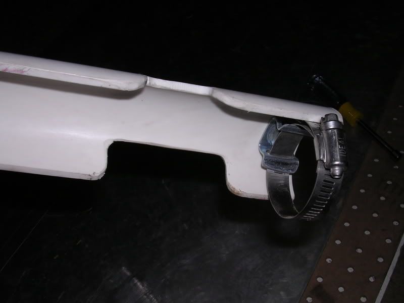

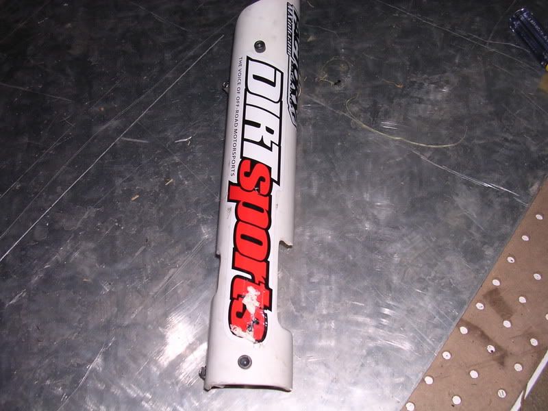

    yeah i do rember because i made them out of 2 inch pvc pipe from home depot and some hose clamps i'll remove one send you a pic...close up! so you can see how easy it is to make them....
    el baja
    Posts:174
    by el baja » Fri May 11, 2007 8:54 pm
    jtcohenour
    Posts:103
    Joined:Wed May 09, 2007 6:43 pm
    Nice Fabrication
    by jtcohenour » Mon May 14, 2007 10:37 am
    You did a great job on your guards. They look store bought. I will try to make myself a pair this weekend. Thanks for the pics they will be a huge help!
    el baja
    Posts:174
    by el baja » Mon May 14, 2007 11:58 am
    yeah just get the 2 inch pvc then cut it right down the middle. then you'll have a left and right then measure and notch out the edges. the hard part is going to be making the bracket, i used an electrical conduit clamp then just made the slots for the hose clamp...good luck!
