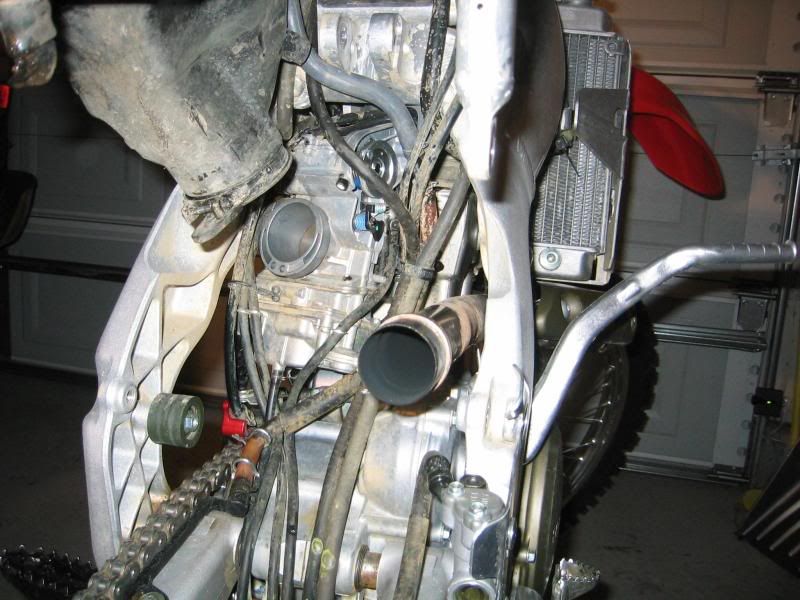

    how in the world did you guys put it on in the bike (250X)? Is this like a "snipe hunt" where yall laugh while I go back out there and try for another few hours to get to it.. I can barely see the throttle cover and have yet to get the cover off... I'm going back to try, hopefully i'll come back in and see some replys with some tips.

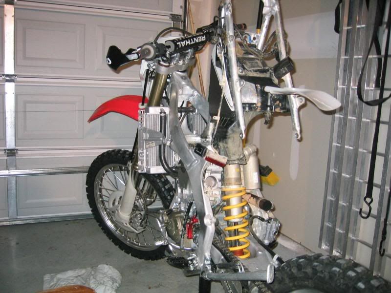

    I thought it was an impossible feat on the X also...but its not. Make sure you are removing the lower subframe bolts and pivot the subframe up but don't go past 90 degrees otherwise you will pull tubes off. Remove the upper and lower shock bolts....remove the shock, and you are in. You can feed an allen wrench from the front and watch it through the back (under the subframe) to remove the AP pump cover.
    Then put the Oring on. I thought it was easy to put the O-ring on by hand with the subframe up and the shock out of the way. I didn't need the floss.
    Subframe up...before shock removal
    Shock Removed...easy access

    I did remove header pipe and that gave me more hand room. with a "pick type tool, i put LARGE oring on screw then came from behind, hooked the oring and pulled it over the black plastic piece. Actually oring went on in one minute. Header off really helped.
    Oring was easiest part, maybe first time luck.
    Getting the throttle cover plate off is what took so long. could never get allen wrench in good spot and hand would not fit in to turn.
    It all went back together easier than i expected also. It looks impossible, but your right, doable.
