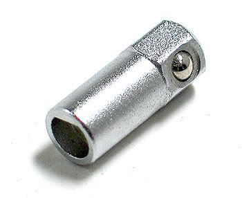

    I can't get the original fuel screw out of an 07 X. My 05 had a screwdriver slot to adjust and or remove. The 07 just has one side of the fuel screw thats flat. Probably an easy solution I just can't figure it out.
    Everyday You Put Off Riding Is a Day of Fun Lost Forever !!
    by Asmith » Thu Aug 02, 2007 2:20 pm
    Dan,
    The stock fuel screw is removed using this tool with a 1/4"socket.
    $2.90 Part # 08-0242 BIT, D-SHAPE F/USE WITH 08-0229
    http://www.motionpro.com/motorcycle/too ... hex_driver
    I have heard of someone's success using a red electrical splice crimp connector to remove it. Bang it into place and twist out with pliers. Don't know that one for sure, but remember reading about it.

    Thanks to ~ I used a 22-18 AWG (red) splice heated with a heat gun. It slipped right on and when it cooled I unscrewed the stock fuel screw.

    82911sc wrote:Thanks to ~ I used a 22-18 AWG (red) splice heated with a heat gun. It slipped right on and when it cooled I unscrewed the stock fuel screw.
    I used the blue one no heating nessecary just put it on and turn
